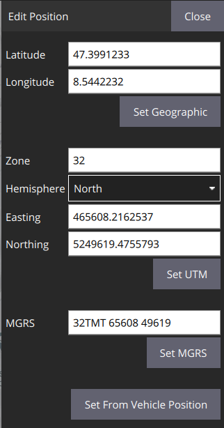

Waypoints: I am shocked that I cant enter a waypoint by typing in a lat/long coordinate. I often plan missions by either collecting the coords on the ground or using other software like google earth. This seems like a simple and important feature and I formally request its implementation. Is there perhaps some other way to create a mission using coords and import it to QGroundControl?

Click the hamburger menu item, select edit position:
Screen Shot 2020-10-26 at 1.26.05 PM
You get a pull set of possibilities for adjusting waypoints positions:

Thanks so much for the quick response and walk through on entering coords! I could not be happier to be wrong about that!
