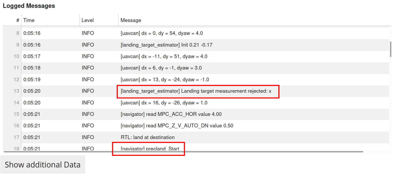

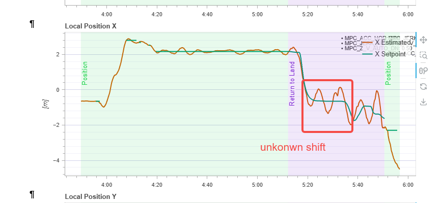

Unexpected poshold shift
here is the log link . custome made board,
base on v1.15.1
Are you aware that you’re using precision landing code and it’s trying to find the target? I’m not quite sure what you have set up and how it’s supposed to work but it probably matters…
