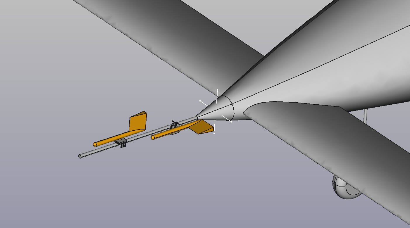

Also, has anyone in this community tried doing a pitch & yaw sensing solution that you know of? We know there are some mini rotary potentiometers out there (
3382.pdf (922.6 KB)
; (this attachment is one of many mini’s out there) printing out some mounts & vanes will not be much of an issue…but we are genuinely curious of others have tried it. It would be awesome to co-locate these on the airspeed probe to have a fully-functional “mini-YAPS”; we’re even validating a potential shape of it against the aircraft in the CFD environment… minimal distruption, given the aircraft configuration and relatively low Re environment.
Here is a basic render:
Again, thank you so much for your help so far; this is seemingly not anywhere near as complex as we were initially led to believe…just small details at this point!
Yes, often certain Flight-Controllers become outdated but can still be used after. - As long as you don’t use one that’s outdated by many years as you will struggle to find anyone who is willing to help you with certain issues that may arise.
You don’t need any additional sensing solutions. - Yaw,pitch,roll, air-pressure (height) is all taken care of by one FC.
However, in regards to speed and fixed wing aircraft you have to decide if you want to use GPS, Pitot-Tube or both.
That’s why it is unlikely anyone would bother with additional sensors like you propose as those don’t readily integrate with FC-system and add more complexity to build.
Bummer!
We fully understand the module provides spatial 3-axis information, angular acceleration data, baro altitude, etc, all of which all holds super-high value for us, and airspeed & GPS data is an absolute must. However, knowing angle of attack & angle of sideslip in specific regimes are both important in the world of aeromechanics, so yes, capturing these two parameters is highly, highly desired. Yes, we know what this model should do, but the whole idea is to validate predictions and assess flying qualities under dynamically scaled conditions.
On a previous similar subscale project some years ago, we used an old-school video camera-tuft-reference point technique that worked good enough to get an informed idea of angle of attack/sideslip, so we could do this if the Pixhawk simply does not have this capability. We had to ask…
What are the default sampling rates of the GPS, Airspeed sensor, Barometric Altimeter and Spatial sensors? Can the sampling rates be adjusted if need be? Knowing this and airspeed at any given moment, should give us a fairly decent AoA/AoS answer!
Again, thank you for assistance!
Just because it is not readily available as a data logging option doesn’t mean you can’t use those additional sensors. Various people done all sort of things in special builds/applications.
But that may involve custom made firmware for flight controller, or perhaps a companion computer to record extra data and combine it with Mavlink messages from FC.
Also this is where telemetry comes in handy as you can all or some data to a ground-station and record it there.
Here is an example of someone trying to do such thing:
Another example:
Sampling rates can be checked in the specs of your particular FC you intend to use.
(Lookup sensor chips used and then google for the specs of each chip)
In regards to GPS it depends if you use a low cost GPS which may provide only a 5Hz update rate or a quality GPS providing at least 20Hz update rate.
You can adjust sampling rates down I believe, but not up as this could cause a FC CPU overload.
Idea: If you don’t require voltage & current data from your battery you could simply use a potentiometer as you’ve suggested and wire it as part of a voltage divider. Then that voltage can be connected to the battery sensing ports. All you need to do is create some reference values before so you know which voltage represents which angle.
  • Or some FC’s have already analog sensing inputs which can be used to record that voltage.
In all above mentioned cases you have to ensure you stay below 5V or in some cases 3.3V for those sensing applications. - Best thing: No additional equipment required. (I.e. companion computer, telemetry,…)
