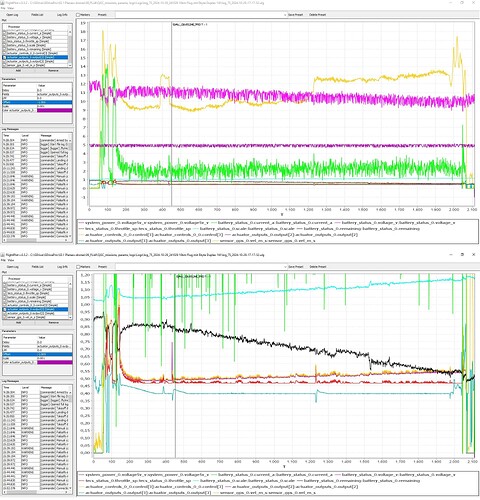

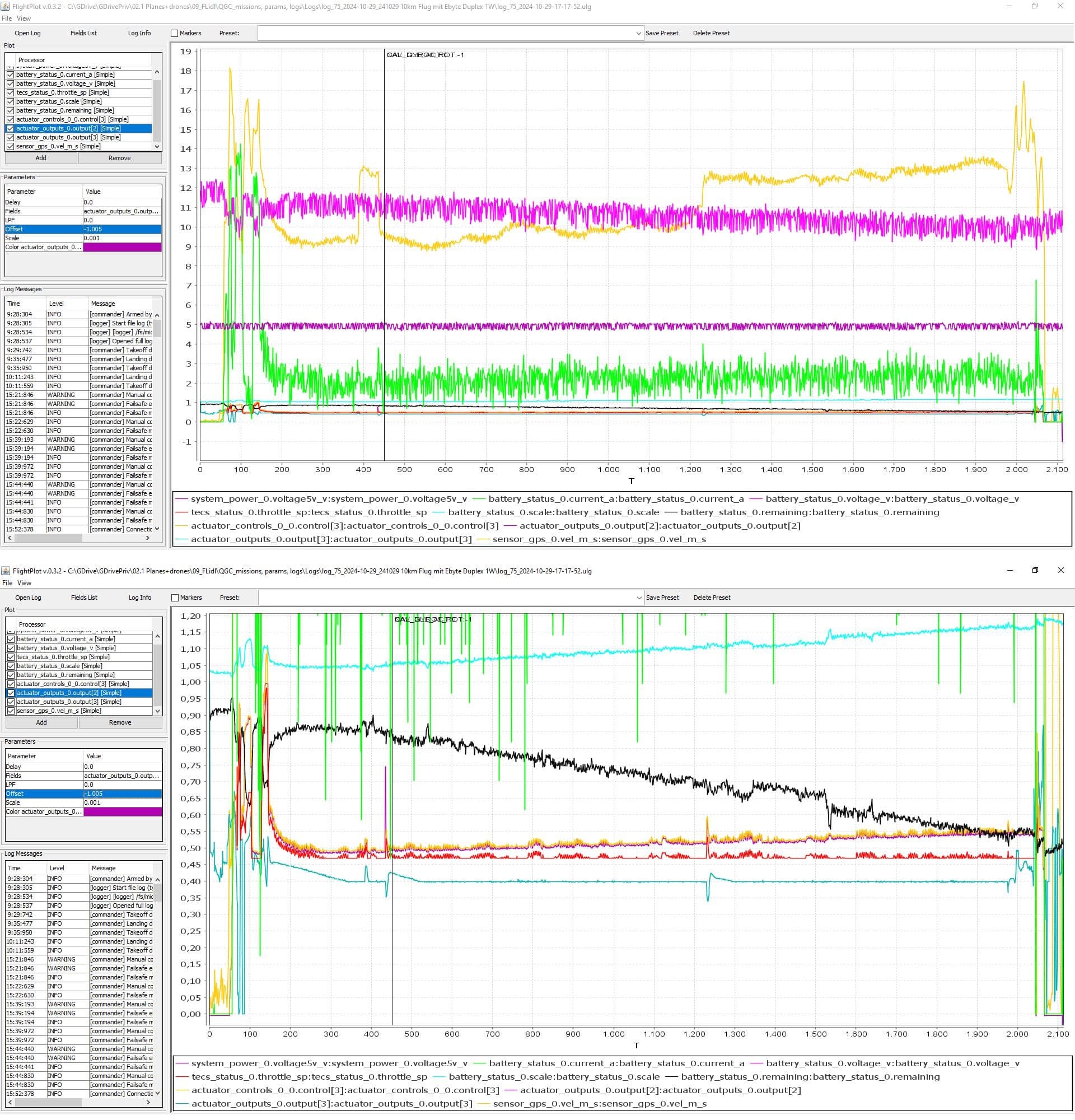

thanks for your answer, I studied through my older Logfiles in the meantime, and found something interesting:
It seems the throttle scaling worked in an older Log from 2024 (Log75 attached), and just didn’t work in my newer flights anymore.
Log75:
34min Flight with a simple 1 waypoint mission, fly out and come back. That’s why the groundspeed changes a bit at halftime, that’s the turnaround at waypoint1.
  • Voltage dropping from ~12,0V to ~10,0V at the end.
  • Batt.remaining goes from 92% to 55% at the end
    (Batt params were: BAT1_V_CHARGED 4.05V, BAT1_V_EMPTY 2.8V)
  • Batt.scale increases from 1,03 to 1,18, so that looks good!
    But I don’t see the result of it, to increase the thottle.
Throttle-output:
  • actuator_output [3]: I expected this to be the right output (I scaled it from 1000…2000PWM down to 0…1 for this diagram)
    it stays at 0,4 during all the flight.
  • actuator_controls [3]: this one increases over flighttime, from 0,5 to 0,55; (this parameter is in range 0…1 originaly, so no scaling added here in the diagram).
    So this looks promising, but is this parameter really the throttle output?
  • actuator_output [2]: strangely this channel2 behaves exactly like actuator_controls [3]. Usually I would expect throttle to be ch3, and elevator ch2, but maybe in this case ch2 is throttle!?

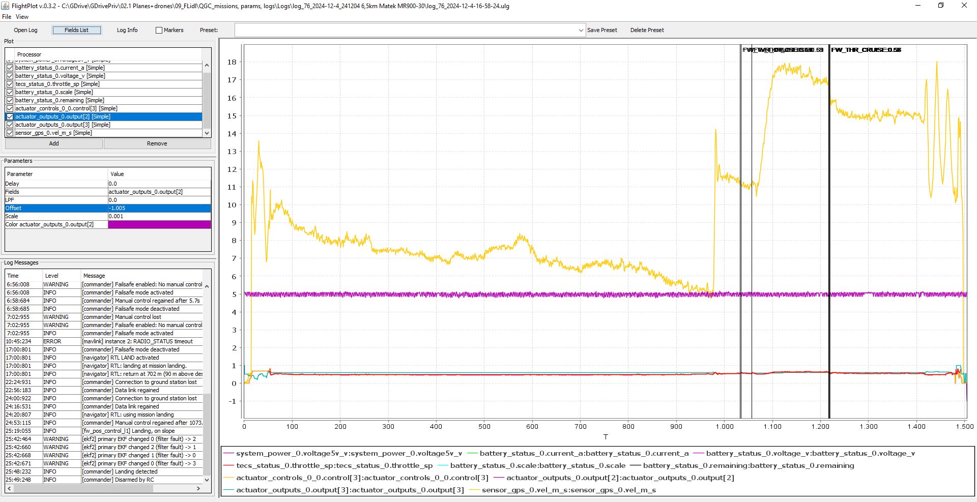

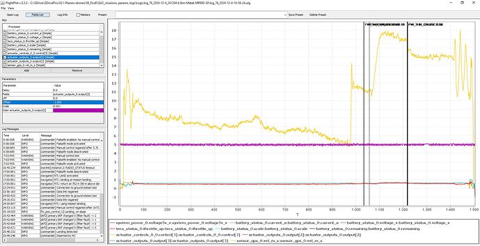

Log 76:
In this plot you can see the decreasing airspeed over flightime, which I mentioned earlier.
But I found another interesting thing: in the Logs almost all BAT parameters are missing!
The attached diagram was created with the same plot settings as Log 75. Much less curves, because much less BAT parameters were logged. The reason might be:
At this time I changed BAT1_SOURCE from 0 to 1. I remember I had problems to display the battery-voltage in QGC at this time.
Seems to me this change was the mistake!
Also in the parameter-file, there are much less parameters. In the list below there are not more BAT parameters, only these few!
So way less than in Log75. I expect that’s the reason why also not more BAT parameters are in the logfile.

1 1 FW_THR_CRUISE 0,55
Conclusion:
  • I need to change back to BAT1_SOURCE 0
  • tune BAT1_V_CHARGED and BAT1_V_EMPTY to get stronger throttle scaling effect
