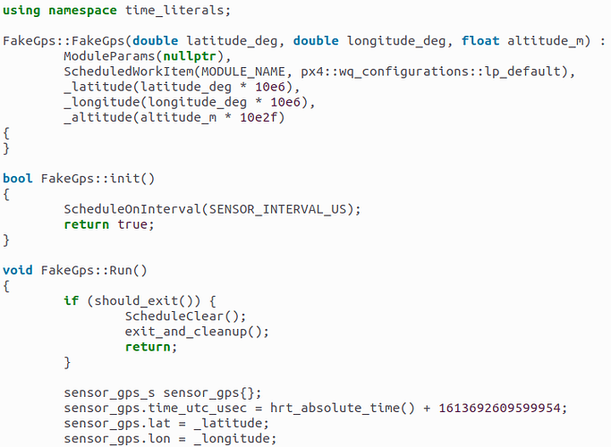

What sort of fake GPS are you using?

I don’t know the sort of fake gps, so I’m posting it as a picture. (some code)
