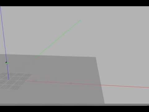

Tailsitter quad SITL altitude hold
Does the stock quad tailsitter hold altitude after transition or just fall off… ?
make posix_sitl_default gazebo_tailsitter
phx> commander takeoff
hover and holds altitude
phx> commander transition
falls off after transition
gives this warning:
pxh> WARN [vtol_att_control] failed setting min values
Screen capture:
Thanks
Im having an issue getting quad vtol tailsitter SITL to work in Gazebo.
The hover mode works fine, but once transition to plane mode is done, the aircraft falls and crashes.
Did the same using standard vtol SITL, and it works fine.
Is there any settings that need to be changed to get the tailsitter sitl working?
Thanks
