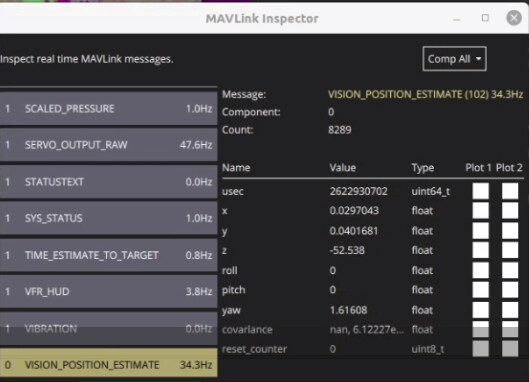

Here’s what I observed:
  • I take off the drone and disable GPS using the command failure gps off. GPS gets disabled, and I can see VISION_POSITION_ESTIMATE messages arriving in QGroundControl.
  • Initially, the drone holds position for a few seconds, but then it starts drifting far from the target object.
  • At that point, I noticed the drone’s pitch and roll angles are quite large — meaning the drone is tilting a lot.
    I’m not sure what i missed, please help me

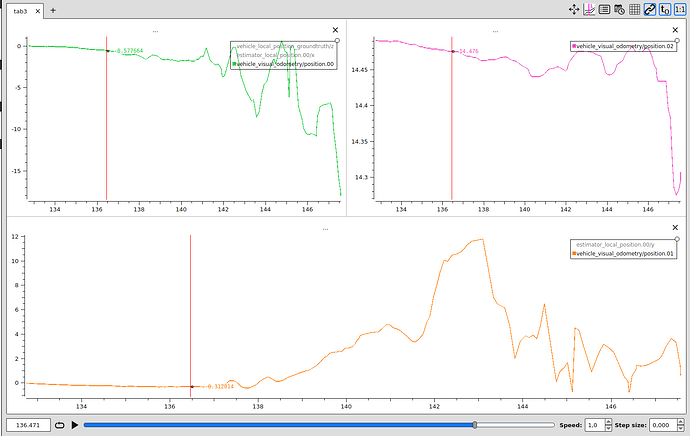

There’s not enough information to offer any suggestions. A log file is the bare minimum for something like this. You should use plot juggler to analyze the uorb data. Look at vehicle_visual_odometry. You can read through the docs to figure out how to do log analysis. I don’t mean to be harsh but it’s hard to offer help when it’s clear the OP hasn’t spent much time to investigate the problem themselves. But even that doesn’t guarantee someone will help you, I wish Dronecode would pay developers to write code and review the issues… everything in this project is charity… :disappointed_face: Anyway, my guess is that the Odometry data isn’t being filled out correctly – missing fields or incorrect coordinate transform. Would need to look at the log.

PlotJuggler showing that the visual_dom position is jumping quite crazy as i dont know what i’m might be wrong.
For estimator algorithms, the software capture the tracked box init position and the translation and rotation matrix of it over frames, drone NED init position is input. the output is the relative position of (camera center) to the tracked box.
So we just feed the relative position X,Y to the VISION_POSITION_ESTIMATE to the drone and let the onboard IMU to solve the RPY inside flight controller.
