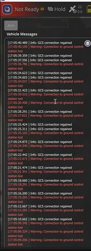

QGC multi-vehicle: connect/disconnect flicker >3 drones (COM_DLL_EXCEPT/COM_DL_LOSS_T questions)
When I connect more than 3 PX4 vehicles to QGroundControl, some start rapidly flipping between Ready and Not Ready with repeated “connection lost/regained” messages. It’s not always the same vehicles, but a few from the group. Limiting failsafe behavior by setting COM_DLL_EXCEPT reduced the visible flicker, but I’m not sure that’s actually safe or addressing the root cause.
I was considering increasing COM_DL_LOSS_T, but I’m unsure whether that just delays the inevitable failsafe or if it helps during the initial connect phase when multiple vehicles come online together.

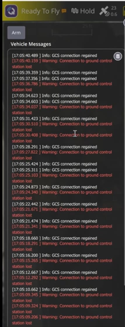

here is it switching from ready to not ready due to connection error
I’d have a look using Wireshark to see what is going on exactly. And if you’re doing this with SITL drones, you can consider reducing the rate a bit at which they blast out MAVLink messages.
