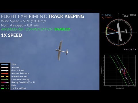

Someone who want to get idea rapidly about NPFG can watch this interesting video about Flying Backwards:

Hi @Alp_Ucan - the video you found is a bit dated for the current implementation on PX4 - you can find a better explanation with params etc in last year’s dev summit talk: https://youtu.be/LY6hYBCdy-0?si=PMqub0RA0ZW2ukqO
