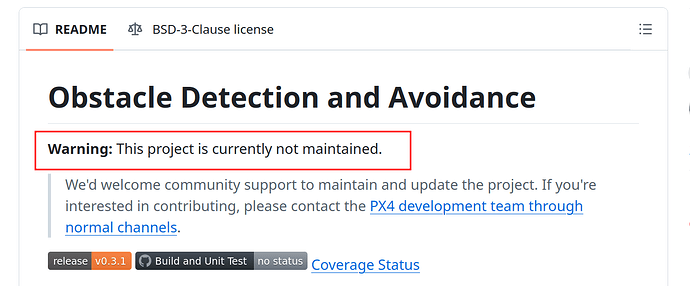

Note that avoidance is not maintained, so unlikely you will get help for this:
