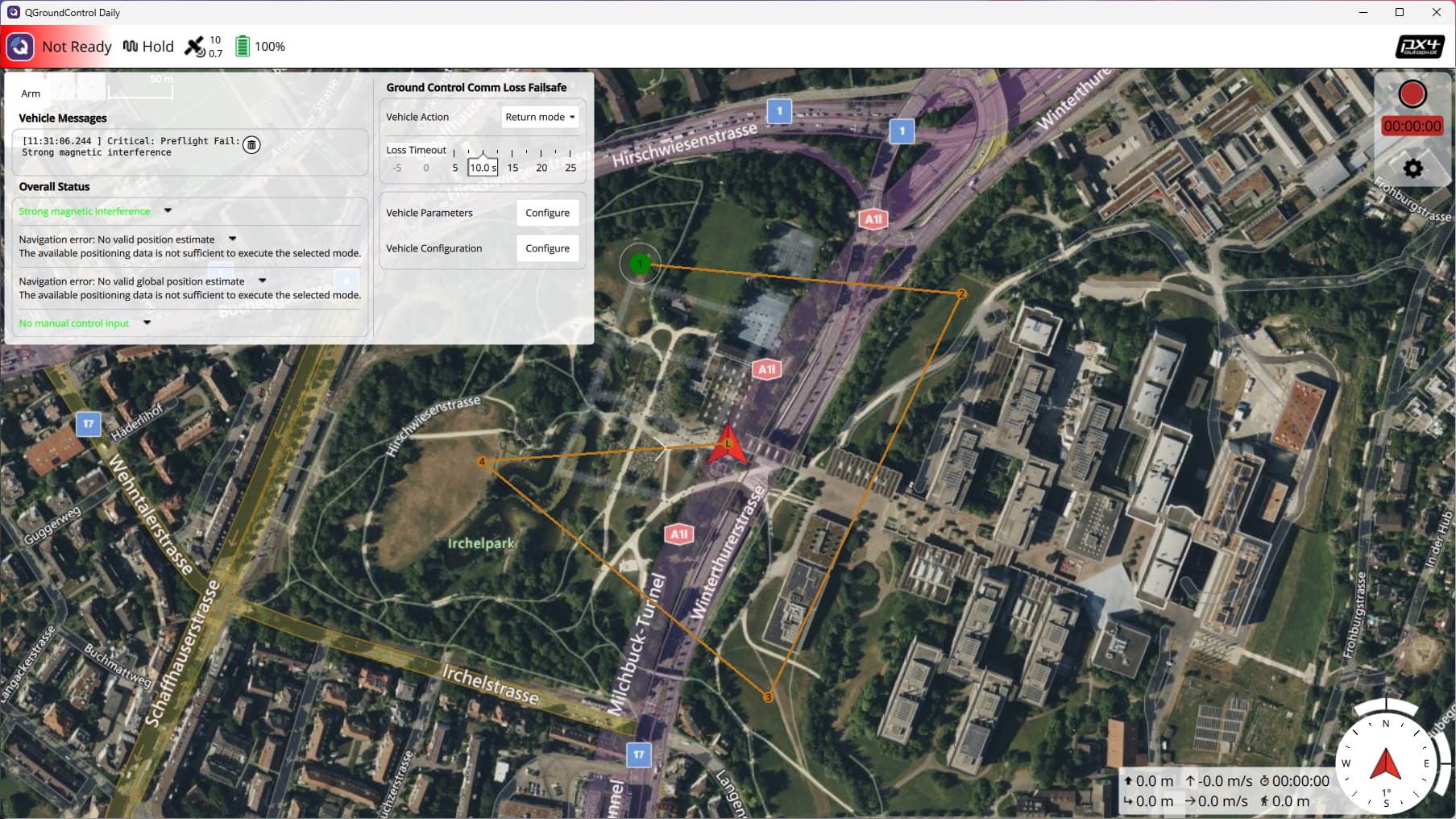

PX4 and QGC Startup In Invalid State
I simply start QGC and then PX4 with gazebo and the x500 vehicle;
and the system is already in a “Not Ready” state.

WARN  [health_and_arming_checks] Preflight Fail: ekf2 missing data
WARN  [health_and_arming_checks] Preflight Fail: No connection to the ground control station

WARN  [health_and_arming_checks] Preflight Fail: Strong magnetic interference

In this case, I think that PX4 or QGC had become corrupted.
I nuked them and re-installed the QGC image, and re-did the PX4 git clone …
After that, the problem seems to have gone away.
