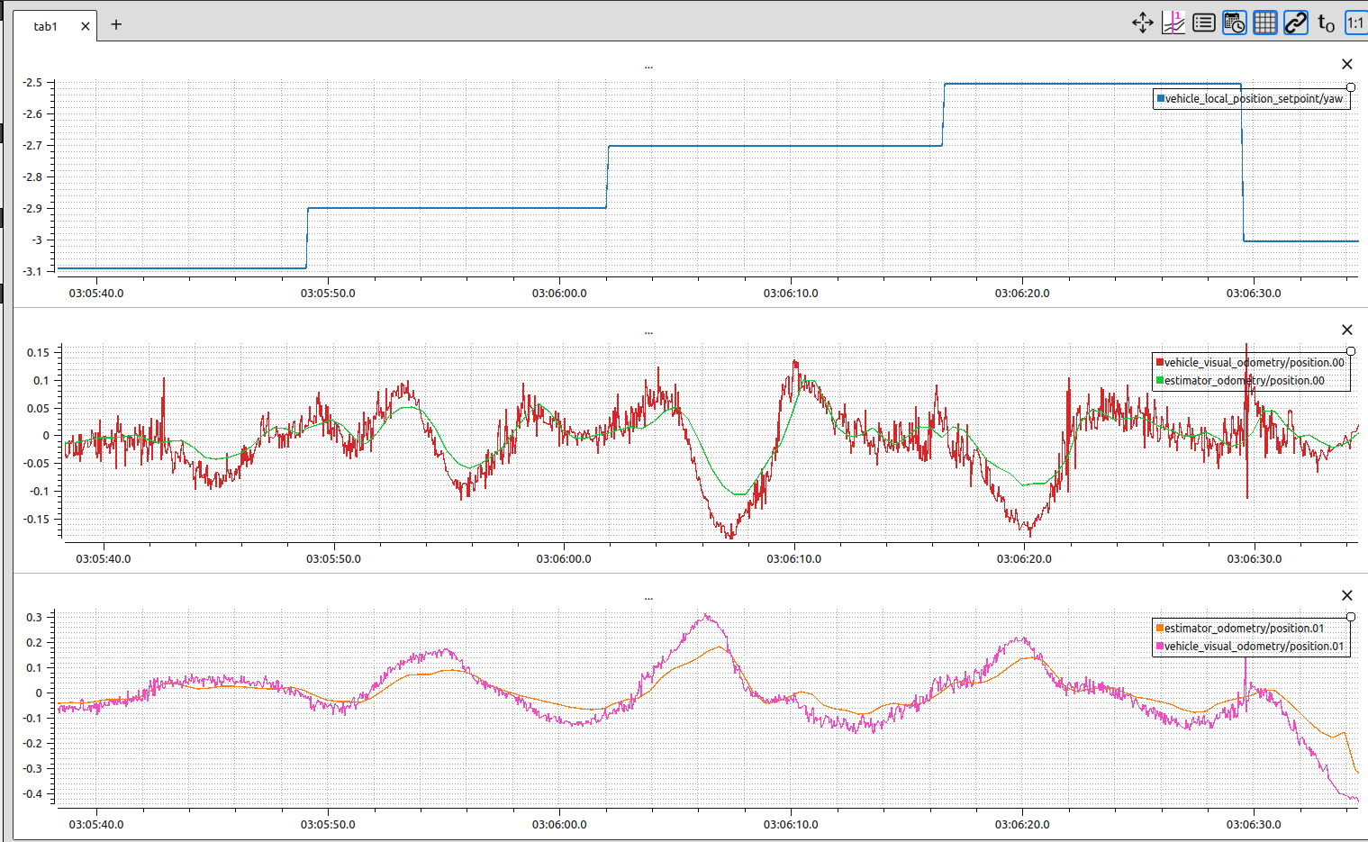

Summary: Experiencing consistent position oscillations of approximately ±0.2m in X and Y axes when commanding yaw rotations via trajectory commands. The drone maintains stable position control during translation-only movements but becomes unstable when yaw is involved.
Hardware Setup:
  • Flight Controller: Kakute H7
  • Firmware Version: PX4 v1.16 (latest stable)
  • Estimator: VIO (Visual-Inertial Odometry)
Flight Conditions:
  • Flight Mode: castum tasks
  • Control Method: Custom external tasks with trajectory controller via ROS2
  • Topics used: /fmu/in/trajectory_setpoint, /fmu/out/vehicle_odometry, /fmu/in/vehicle_visual_odometry
  • Environment: VIO-based navigation (no GPS)
Observed Behavior:
  1. Drone maintains stable hover during position-only commands
  2. When yaw commands are sent (while maintaining XY position), drone oscillates ±0.2m in horizontal plane
  3. Oscillations appear to be coupled with yaw rotation timing
  4. Translation-only movements work smoothly
this is the flight logs
i glad if some one say params i need to cahnge
