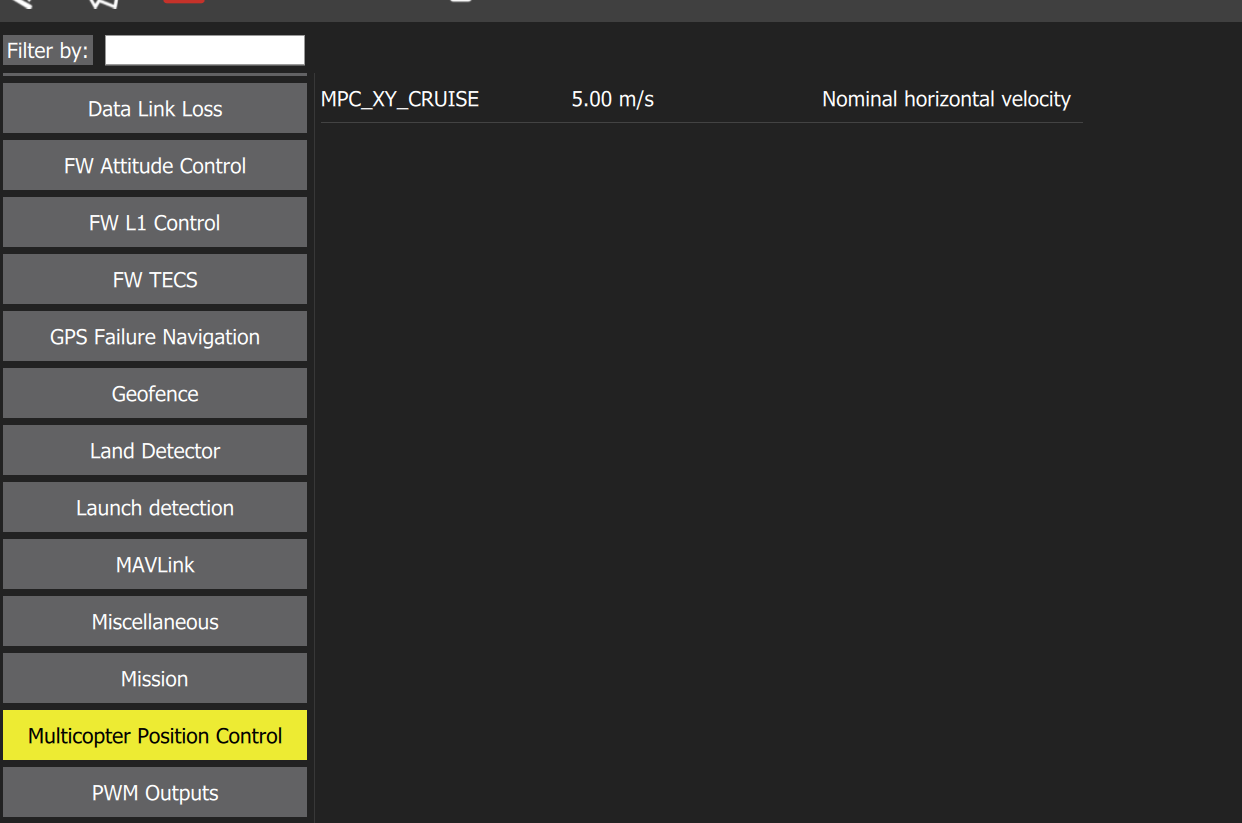

Is this the parameter I need to change
FW L1 control, look at airspeed. What you are looking at is for Multicopters (as the label left says).
@LorenzMeier I’m looking for the parameter @tumbili was referring to in order to set a minimum ground speed so I don’t get stuck in the wind or slow right down. I am trying to set a minimum ground speed of 10 m/s so if I have a 10m/s headwind instead of flying at 5 m/s I will maintain 10m/s ground speed and my airspeed will increase itself to 20m/s. He said it was in position estimator but I do not see it.

No. Use the search field to look for FW_AIRSPD_MAX. The system will adjust the minimum ground speed accordingly to FW_AIRSPD_TRIM and MAX. You don’t set the min ground speed yourself.
Thanks that makes sense I was thinking it worked like APM. If I am understanding this correctly the system measures the wind speed and provides throttle as required to overcome that and maxes out at airspd max.
