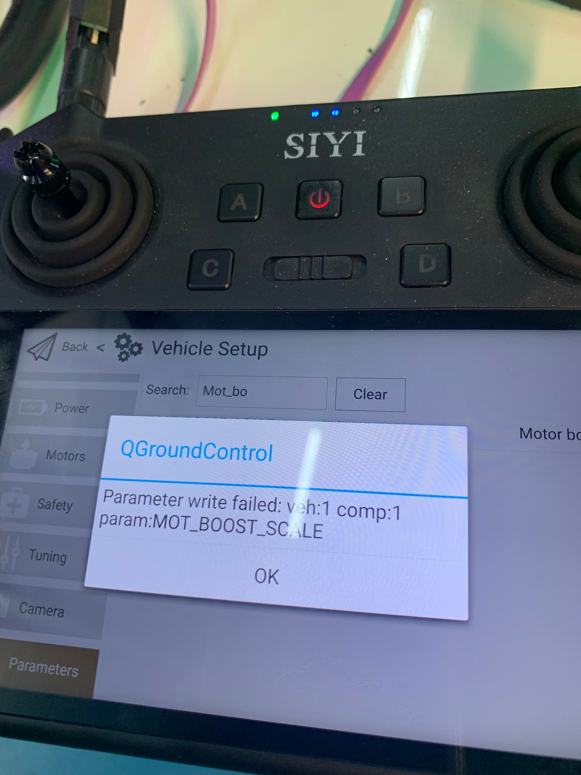

Using QGroundcontrol on a SIYI MK15.

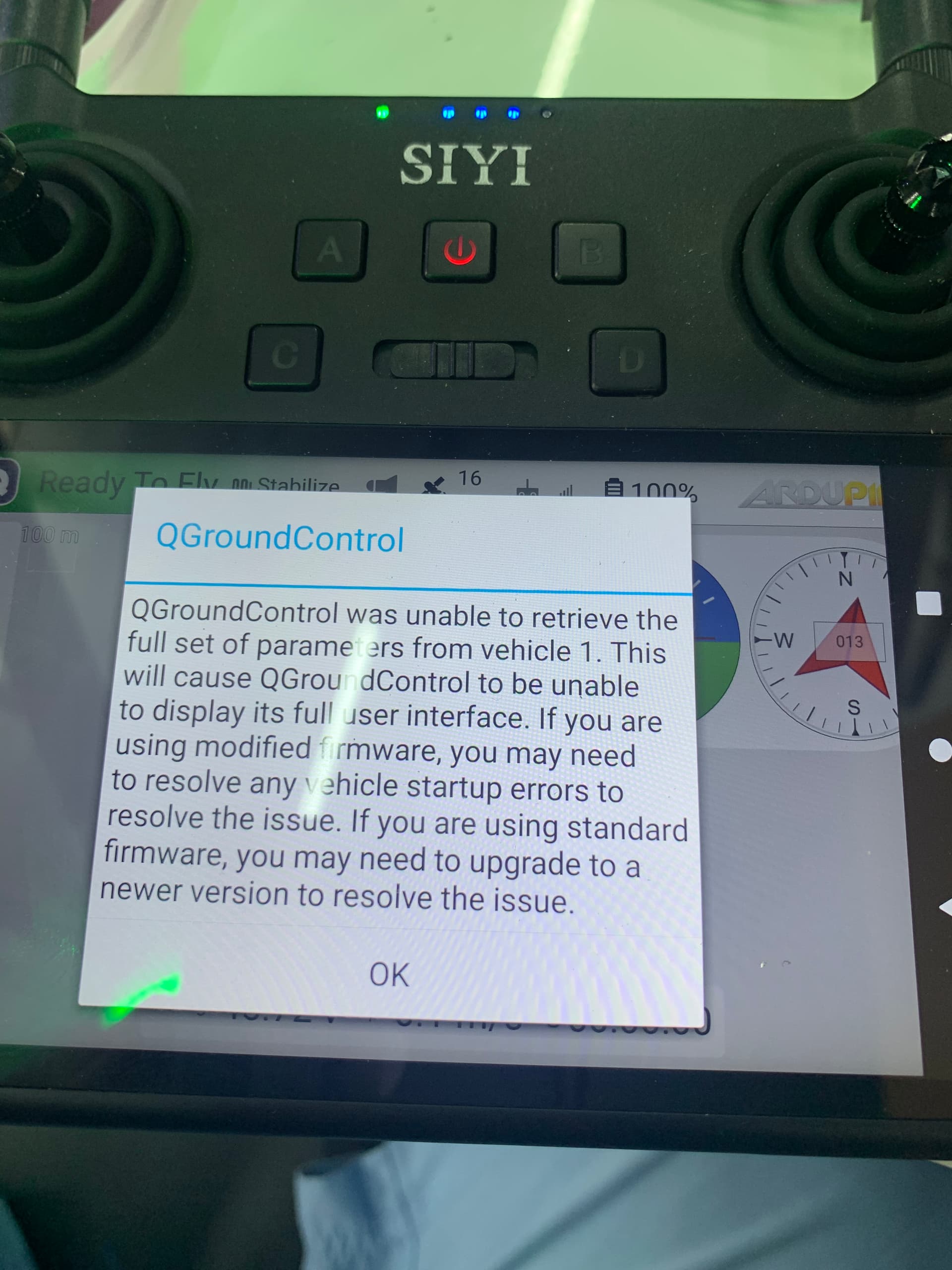

When using 4.1.0 copter stable, I keep getting the following messages seen in the photos attached.
I also can’t access a lot of the QGroundcontrol features like calibrate radio etc.

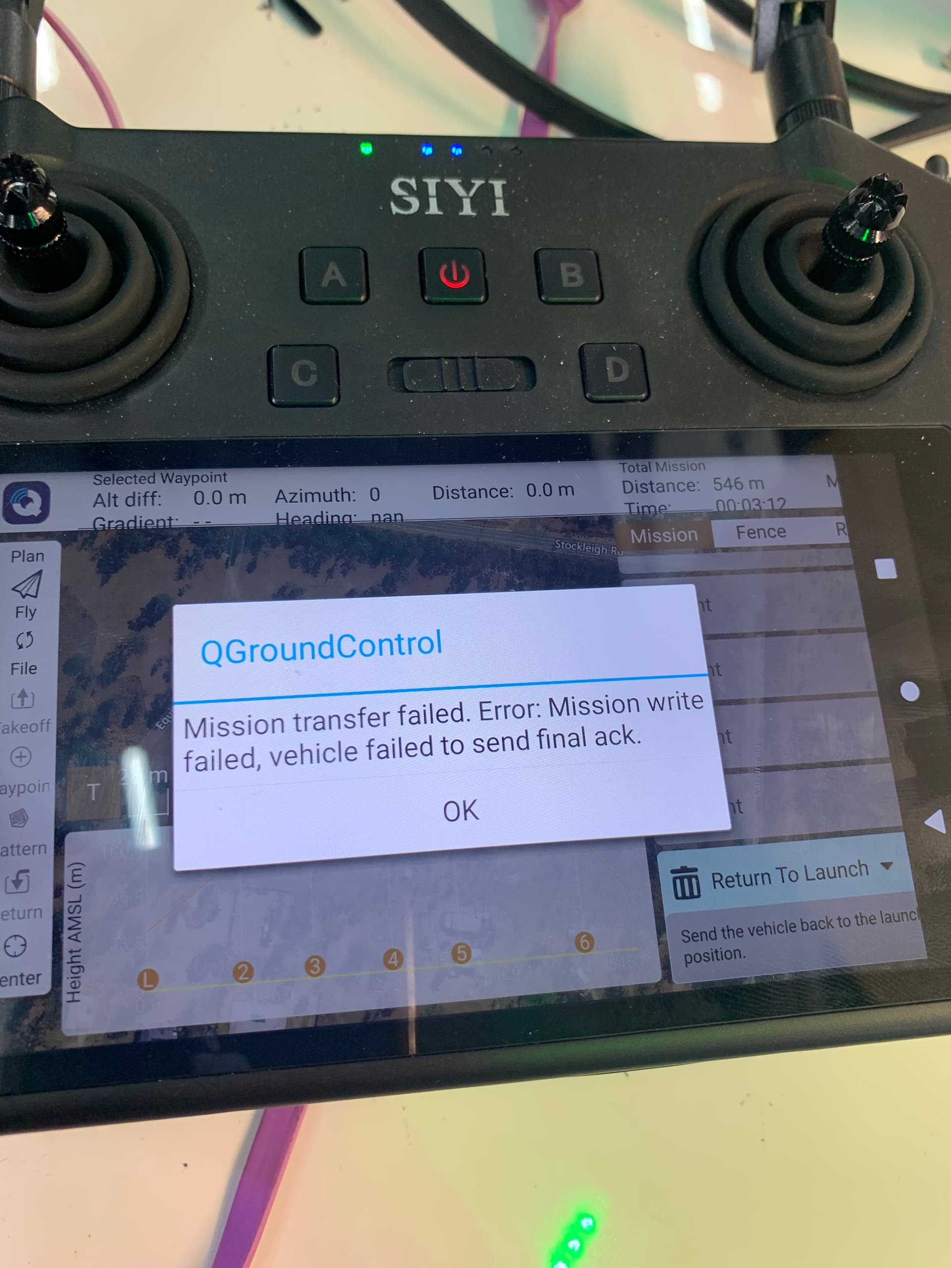

Also says failed to update parameters when I change something or when I try upload a mission it says fails to upload. Even though when I check on mission planner through USB I can see the mission was uploaded and the prams changed.

Just tried the new daily build and same issues. No problems on 4.07 copter. But won’t transfer all parameters with 4.10

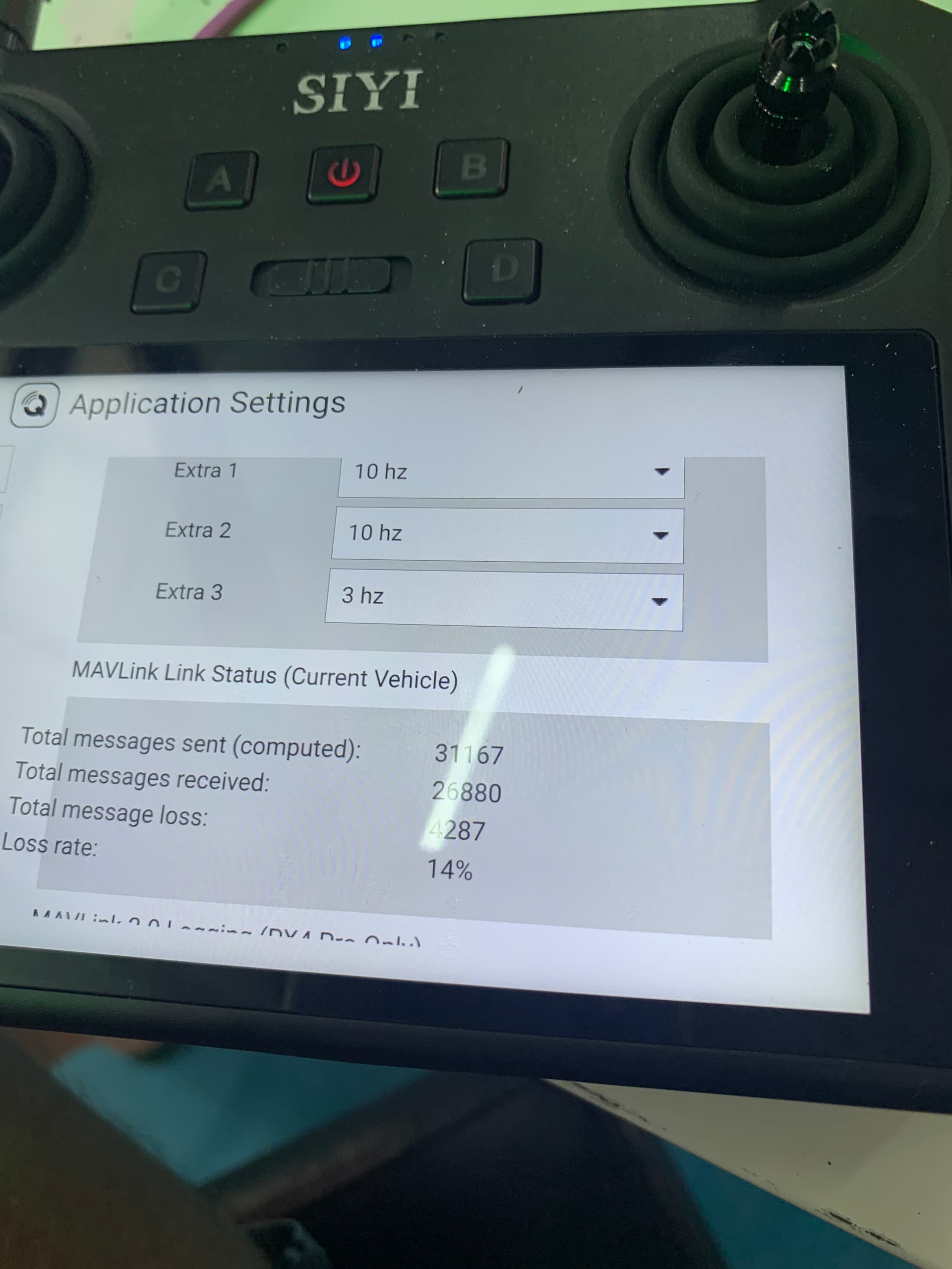

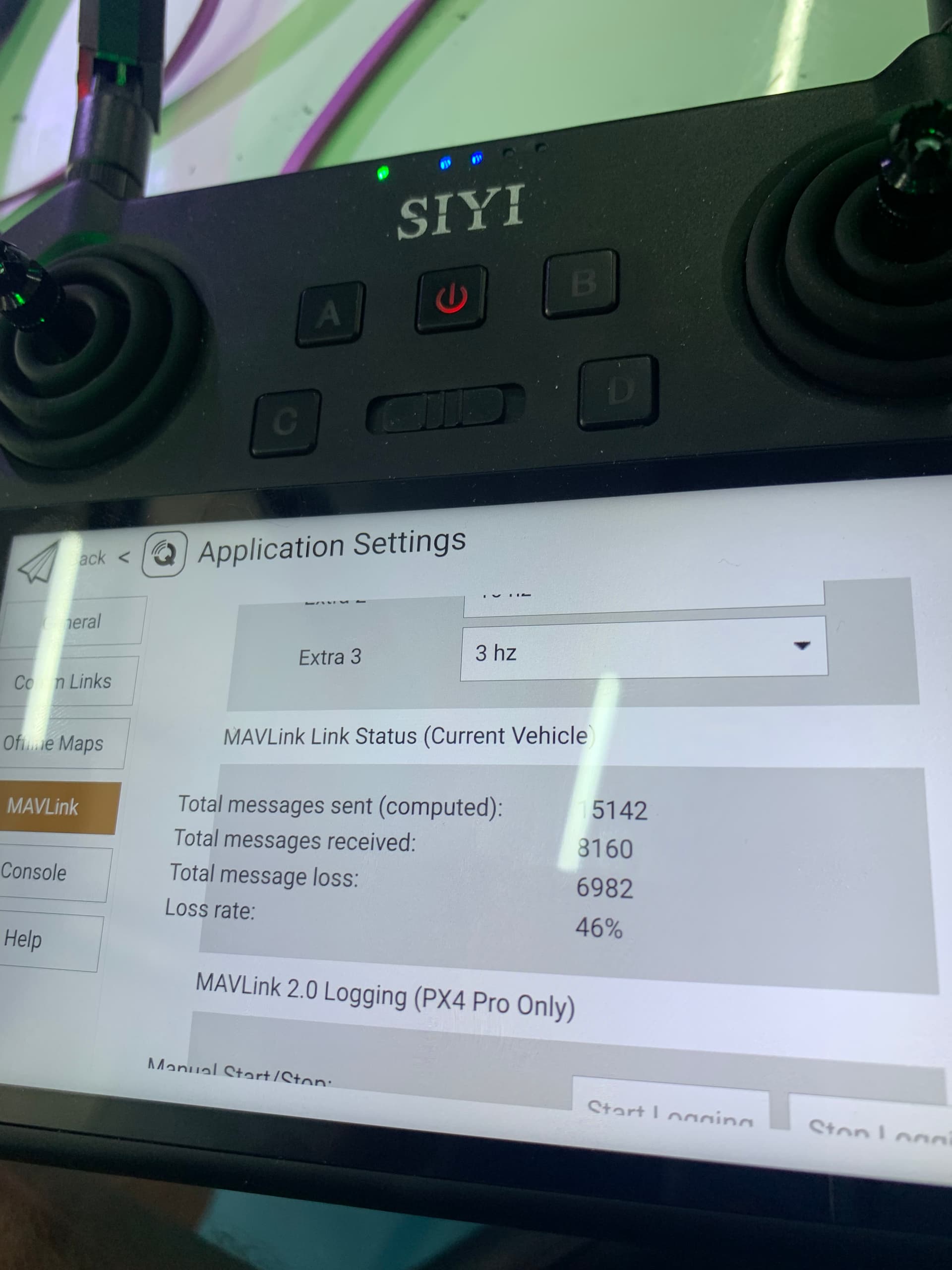

Also using 4.1.0 data loss is at 46%
Using 4.07 I only get 26% initially then it decreases to 14%
