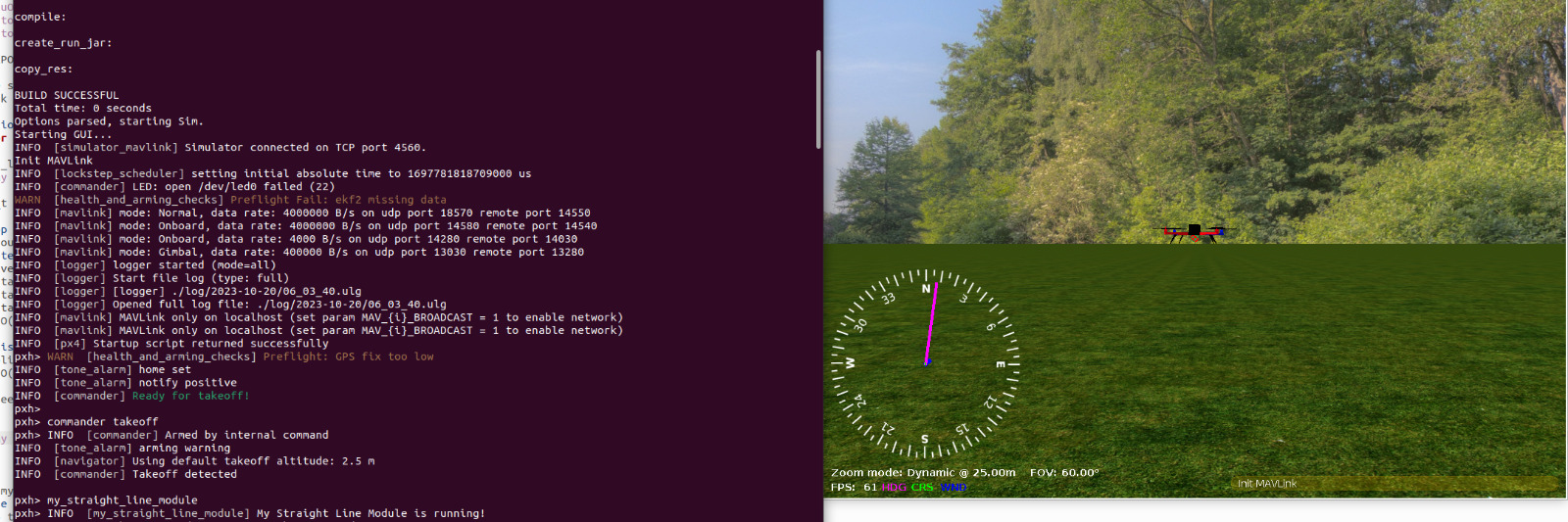

I’m currently learning PX4 firmware, and I wrote this code; it was built successfully into px4-firmware but not able to fly the drone to a particular position. There were no errors. The drone simply stays in HOLD mode when operating with jmavsim simulator.
Note: Initially the code worked and started fly the drone but suddenly it went hold position then afterwards it doesn’t do anything. You can see the simulation in picture.
Any help appreciated. Following is the code I’ve written:

I am also tried this code to publish the velocity and to read both position and velocity I am able to read both data but not able to move the drone using these commands in jmav simulator. any help can be appreciated.
I suggest you have a look at the flight tasks module. Maybe you can add your module in there. Otherwise, you might be fighting the other controllers running with your module.
Also see: Flight Tasks | PX4 User Guide (main)
Thank you @JulianOes for your reply, I followed the flight task documentation and successfully build my task into px4.
But not able to fly the drone with my task.
I followed the whole documentation and did everything as they said and for testing, I enabled the MPC_POS_MODE 5 for running my task.
The code is giving the outputs that both activate and update functions are called successfully but I am not able to fly the drone to my desired position.
When testing the task created by me for jmavsim, I was not able to change to position mode after using commander takeoff and if I first switched position mode then I am not able to arm the vehicle.
can you please explain what the problem in might be switching modes and could you please take a look at code and check it is this the correct method?
if my method is wrong, could you please tell me what the correct way is to run my task for jmavsim.
Thank you in advance.
