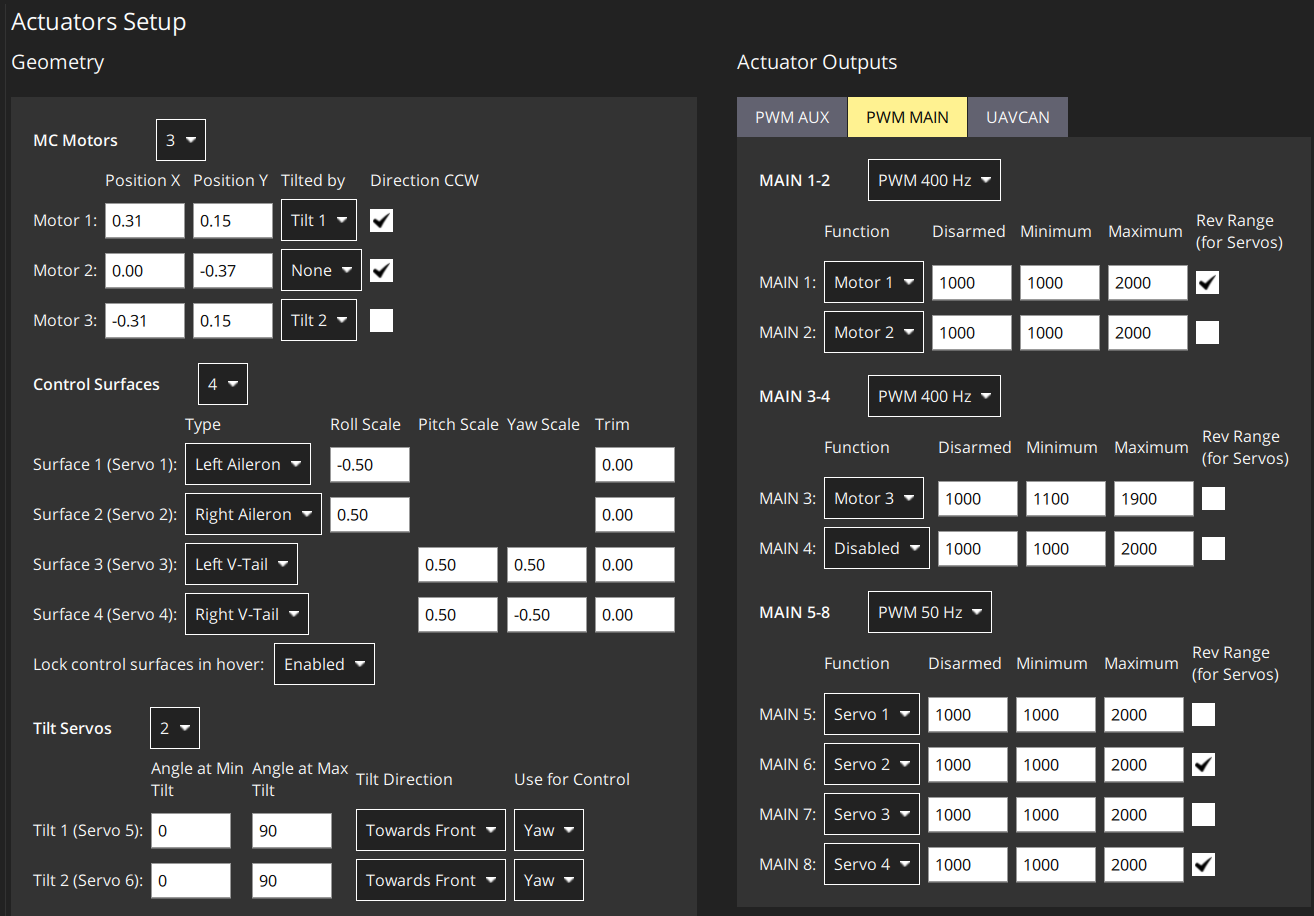

I’m working on a 3-motor VTOL Rotorcraft, two motors forward, with one on tail boom, front two have servos to rotate motors from vertical to forward for FV mode.
I have the rotorcraft/FW mode change working, and tilt motors are set with one being opposite as they are mirrored. When in RC mode, with both motors vertical, and attempt a LEFT YAW with stick, both motors tilt about 10 deg forward; I believe that just the right motor should tilt rather than both. I have no movement of either when commanding right YAW. Using PX4 X6 and Radiomaster Boxer transmitter.

In Actuator tab, I get yaw with correct mappings. In Airplane mode, both v-tail ruddervators work normally for pitch/yaw. In moving between rotorcraft and airplane, the motor tilt servos work as desired so we know servos do work, and Yaw inputs from RC seem to be passed. The issue seems to be constrained to Rotorcraft mode in one yaw direction only.

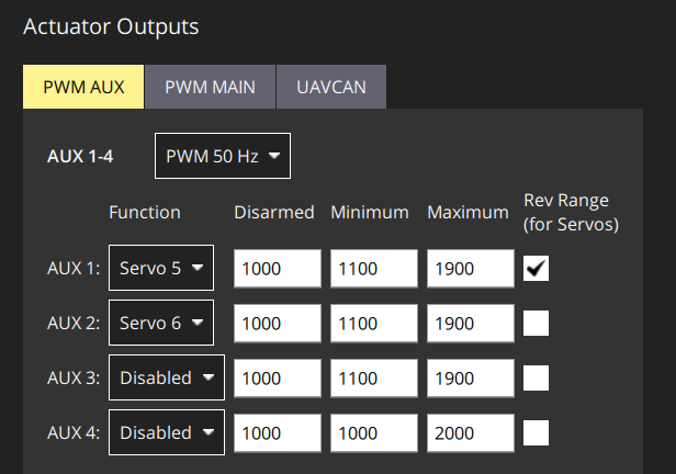

Here’s the current layout for Actuators. Note that we have the Tilt servos mapped as AUX1 and AUX2 (not seen on this tab):
If yaw input shows up in the Radio tab but not at the AUX outputs, then the Control Allocation isn’t mapping yaw to the tilt servos.
In QGC UI you can configure this under Actuators → Control Surfaces / Tilt Servos, but if it still doesn’t respond, the next step is to check the Control Allocation code.
For tilt-rotor setups, yaw is handled in ActuatorEffectivenessTilt.cpp under the PX4 source (src/modules/control_allocator/). If that module doesn’t implement yaw contribution for your tilt configuration, then assigning “Yaw” in QGC won’t have any effect.
So the downstream place to look is the Control Allocation / ActuatorEffectiveness implementation, not only the UI.
