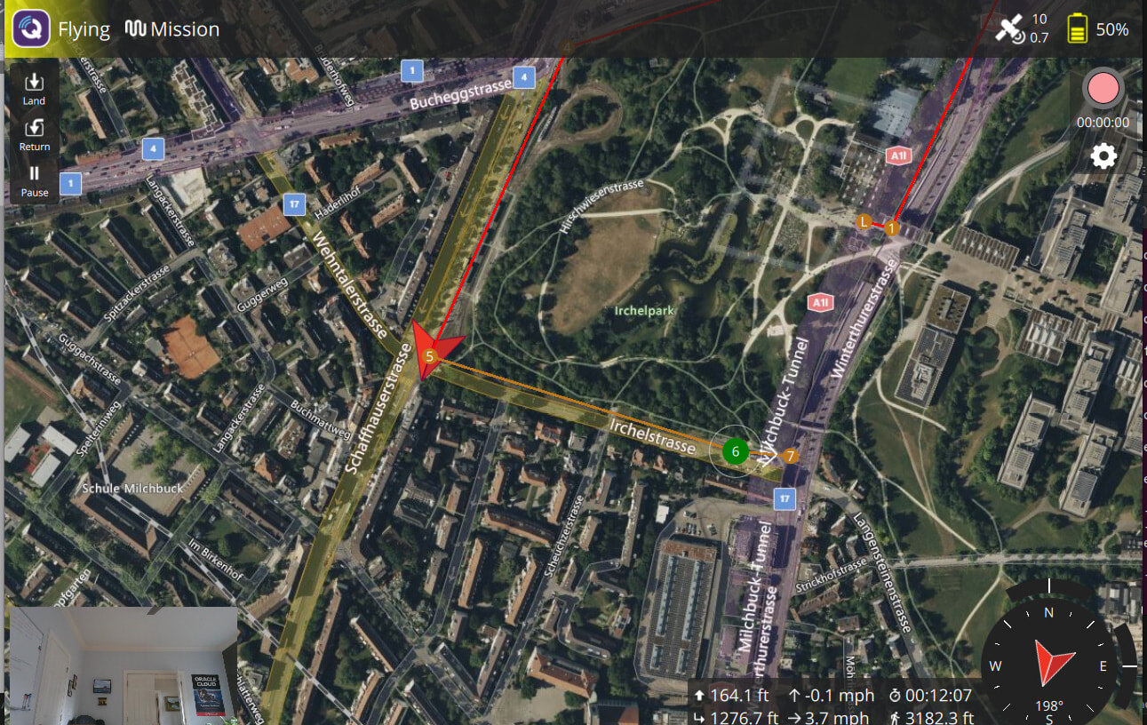

I am flying a mission and observed the flight but I don’t see the actual live flight view in the camera below. It is still showing my office. How do I configure to show the live image?

Hi Mustafa
It doesn’t require configuration—if a video stream were received, it would be displayed. This indicates the stream isn’t arriving at all. I suggest checking whether any video data packets are actually being received, which they likely aren’t.
Hi @nitru Thank you for your reply. Could you please elaborate how I would check if video packets are being sent and received? Are you referring to Video Overlay section in QGroundControl here?
Mustafa
I did not refer to any QGC tool.
It now heavily depends on your setup. Could you elaborate where the video is from, and how it is transmitted?
