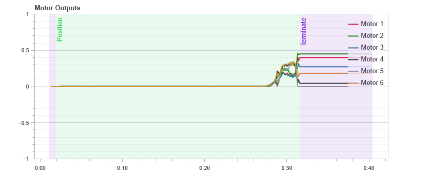

I have a hexarotor and used flight termination along with attitude failure detection for my test flights. A slight problem I always had with this, is that after flight termination, the motors kept spinning at a very low speed, even below the set minimum level (see video below). I have the following PWM values for my motors:
  • Disarmed: 1000
  • Minimum: 1100
  • Maximum: 1900
So far I tried a few things, like different failsafe values for the motors. But even values of 900, 0 or even -1 (so disabled) don’t resolve the problem. Has anybody experienced similar behavior or knows how to resolve it?
Link to the video: Flight Termination.mp4 - Google Drive
Can you share a logfile from boot to shutdown (using SDLOG_MODE).
Here is a logfile of a test flight, where I just moved it by hand like last time: https://review.px4.io/plot_app?log=262aa631-7a18-4da9-8b94-0ac80fc24c3b
All motors have -1 as failsafe value (so disabled). I use OneShot for all of them .
It looks like the motor values just “get stuck” at some value:

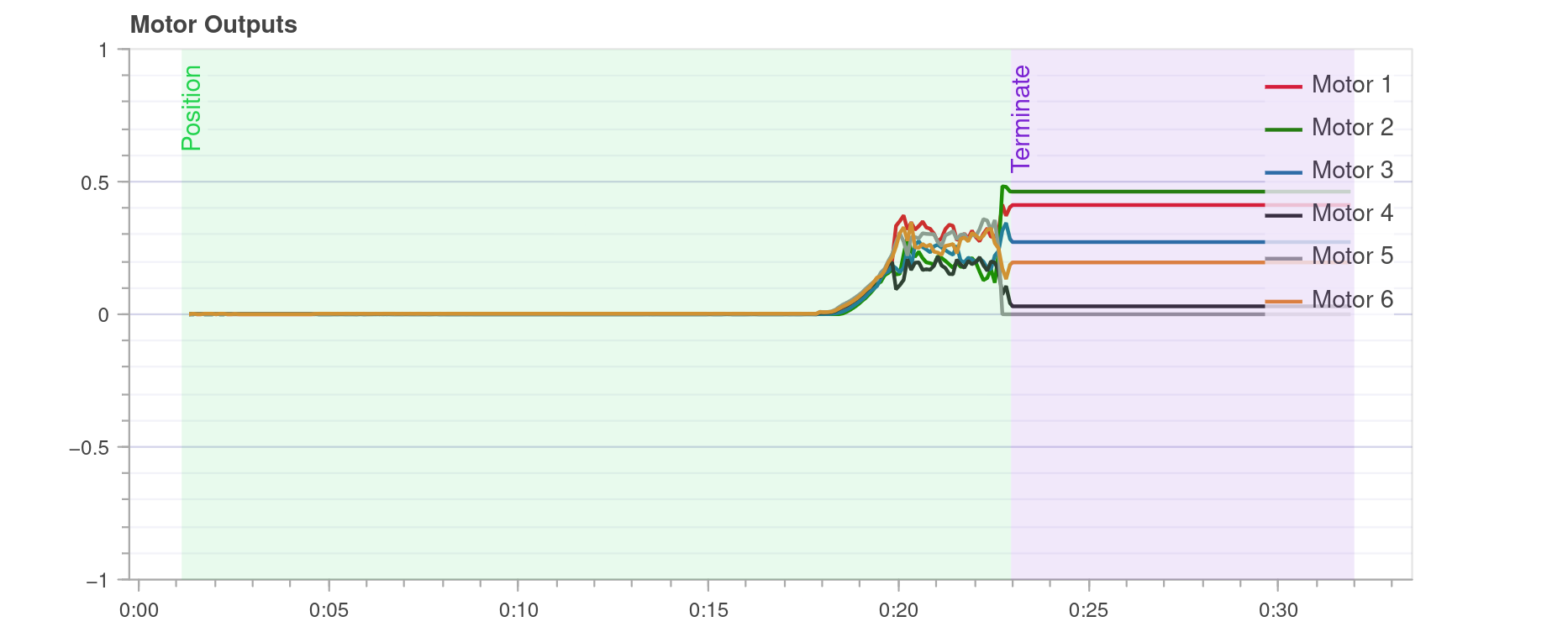

@JulianOes I just had some time to do a test with PWM 400 Hz. The motors fully stopped as I’d expect them to. Surprisingly, to me, the motor outputs in flight review don’t go to zero as well:
Flight Log: https://review.px4.io/plot_app?log=87a53b8c-e640-486f-baa0-b00f7927488b
