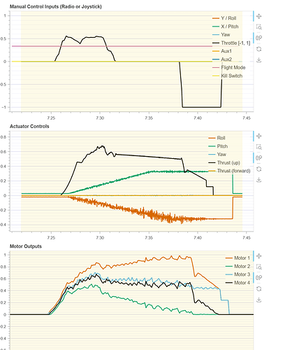

My motors don’t seem to be commanding in unison as I’d expect.

Before attempting to fly the drone - I wanted to run it up on the ground. What I found was the motors spool up evenly, then seemed to have different RPM when I returned to sticks center, and finally when spooling down were very uneven (back left stop way earlier than the rest).
Is this normal? Or is something not configured correctly?
Log and video linked.
Log link here: https://logs.px4.io/plot_app?log=8c513da1-1109-44b6-84df-57a042b7b71f
Video: https://drive.google.com/file/d/11wfZwgmXfJy6wZuaAsBsevq7LcsuHVJu/view?usp=sharing
Motor 1 and 4 look reasonable, but 2 and 3 are just doing their own thing at the end
When you arm in a stabilized mode (stabilize, altitude, position) the controllers try to keep the frame level. Without props this is obviously not possible. In your log you have a slightly positive roll, which means the controllers will wind up in that direction. Given that, we should expect to see the motors on the right side commanded a larger value (we do see that in the log, output 0 and output 2).
To verify the motors spin with the correct RPM throughout the full output range I would instead recommend using QGC Actuators page and the motor test slider.
