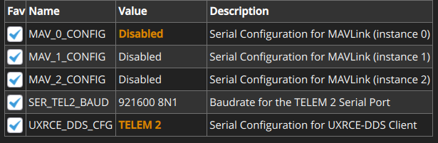

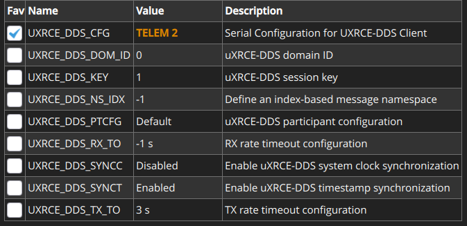

In order to setup the uxrce_dds_client on PX4, I’ve set those parameters :
Then I’ve disconnected the power supply of the Pixhawk, which is a USB-C cable connected to my PC, and started the MicroXRCEAgent :
