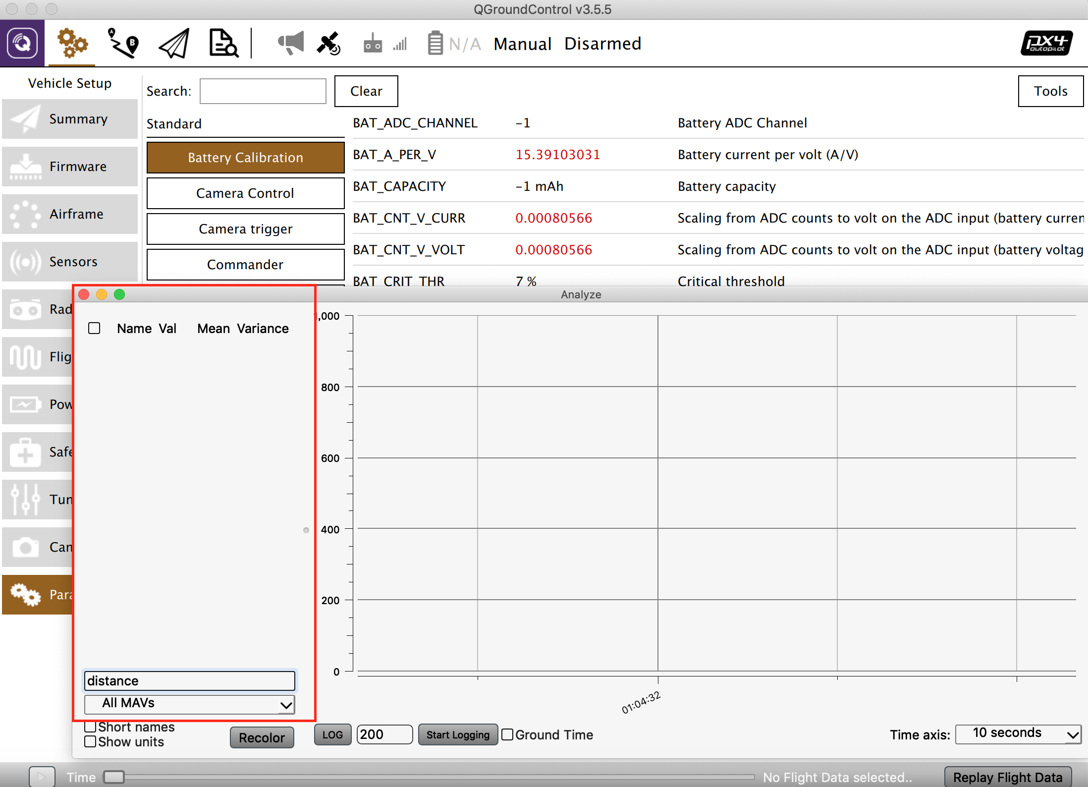

Lightwave 10 / b does not work.
I couldn’t do both serial and I2C.
The parameters (SENS_EN_SF1XX, SENS_EN_SF0X, SENS_SF0X_CFG) exist.
Does anyone have similar problems?![]()

I thought it was not working because there was no DISTANCE_SENSOR message using the analyze function of QGC.
I can get distance data using the Lightware terminal.

I was able to receive the distance_sensor topic!
Here are the results I got using the mavlink shell.
