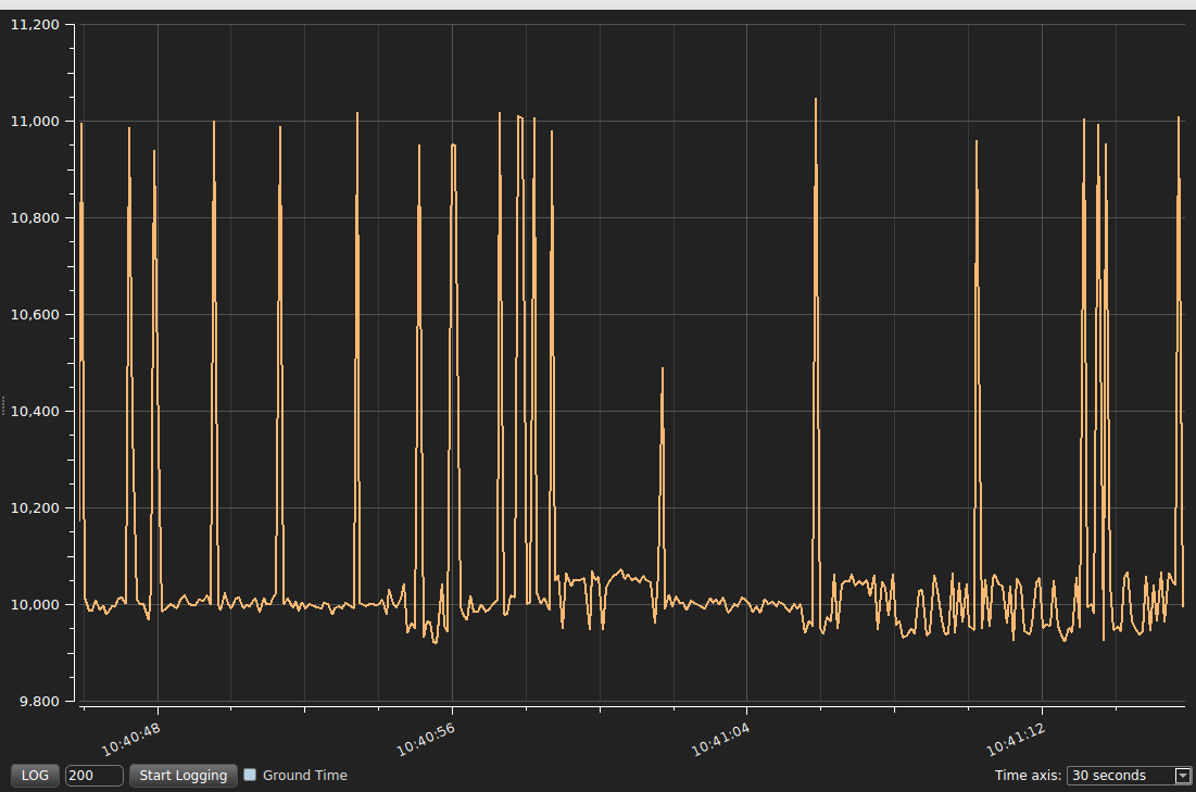

Also I noticed that PMW3901_SAMPLE_RATE is set to 10000 or 10ms but is not guaranteed by the system.
When measured dt between the measurement, it is not solid and off about 2 to 3 ms and sometimes gets to 10ms delay.
/-----------------------------------Added below
Below plot is time dt of flow data gathered while flying. I clearly shows there are lots of jitter in timing.
-------------------------------------/End Add
If dt becomes more solid, stability would be much improved.

For the jitter you can try to run the driver on the high-priority work queue: change the following 2:
to HPWORK.

It works!
Not I am getting dt between flow measurements more close to 10ms and 11ms at worst case ase below.
Overall position control performance is to be investigated but it looks good not.
