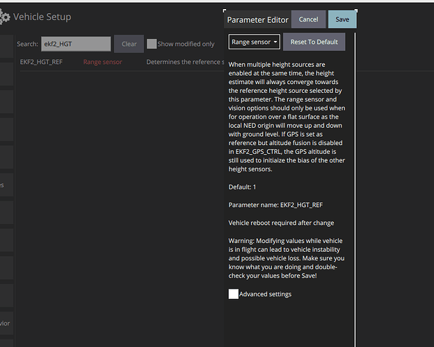

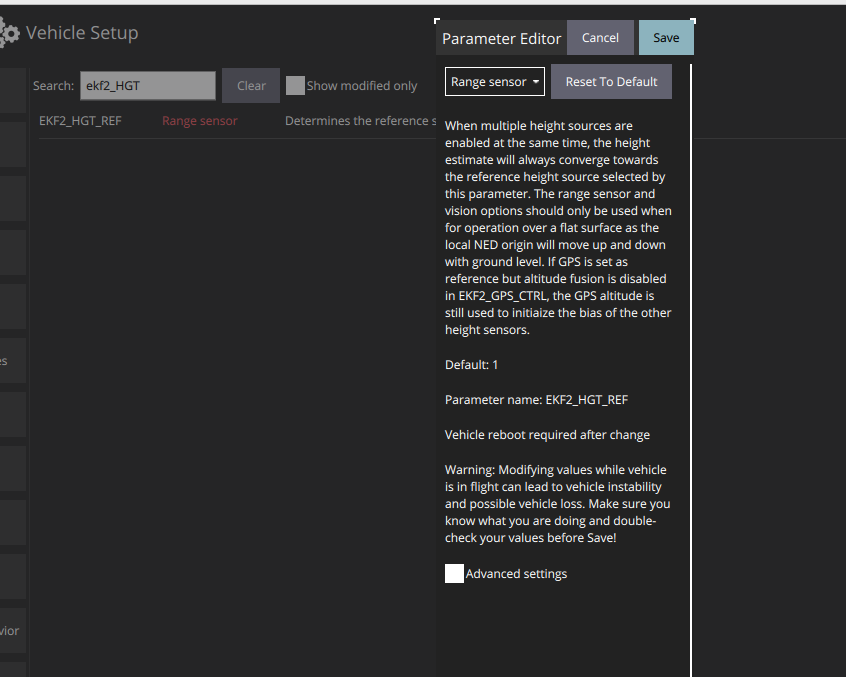

So, I modified EKF2_HGT_REF from GPS to Range sensor as shown in the picture.
I did “ekf2 stop”, “ekf2 start” and then I looked again and the range changed to -0.5 to 0.5 like the picture.

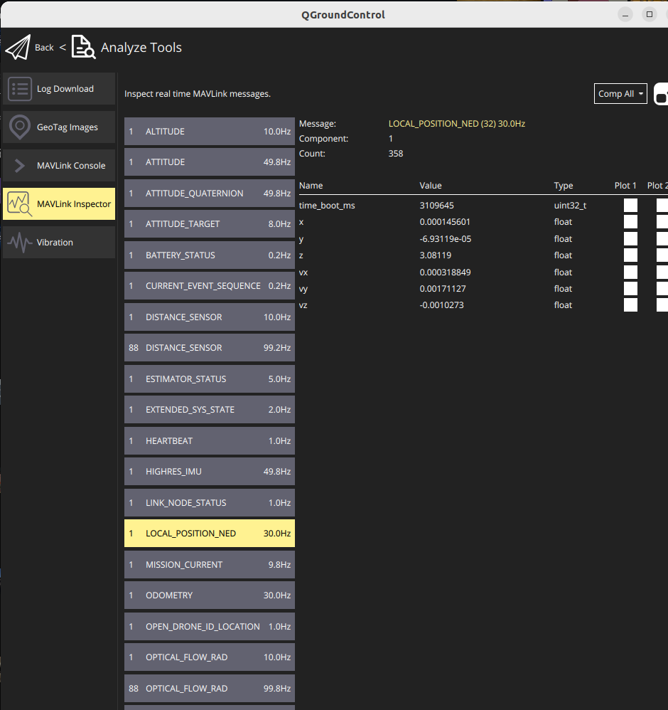

So I moved the drone with LOCAL_POSITION_NED to see if the sensor was working well. But when I moved the drone, the value changed, but when I left it still for a while, it went back to 0,0,0.

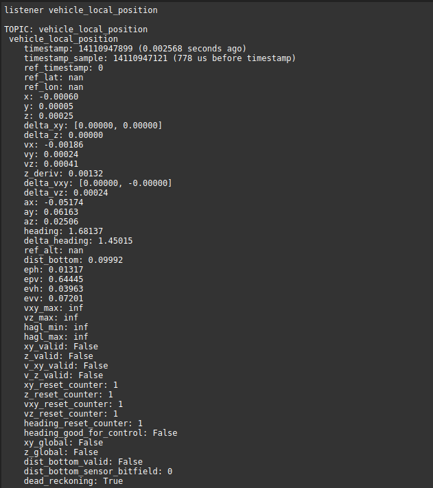

I checked the drone information because the drone doesn’t seem to be able to find its current location.
I confirmed dist_bottom_valid: False.

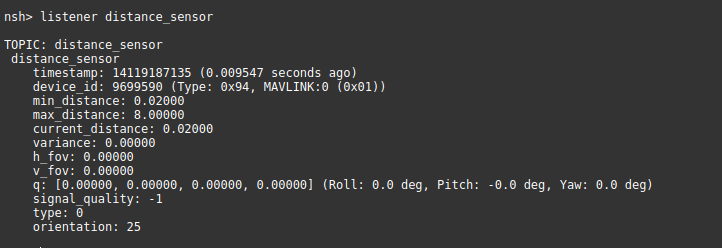

I checked distance_sensor.
I don’t know why I’m getting False.

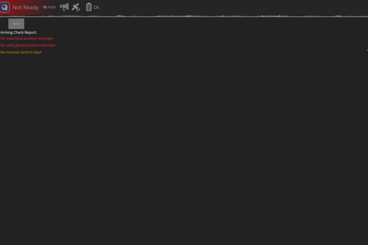

It comes out like this when it’s hold mode in QGC.
