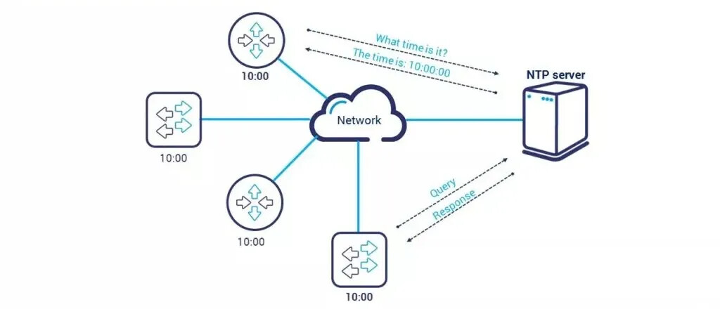

NTP (Network Time Protocol)
NTP synchronizes system time through network servers, generally achieving millisecond-level precision, suitable for low precision requirements. It is easy to deploy but susceptible to network latency, widely used in servers, industrial devices, and robotics.

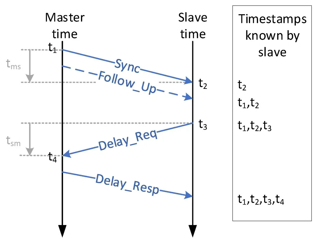

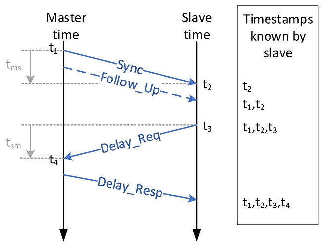

PTP (Precision Time Protocol, IEEE 1588)
PTP provides high-precision time synchronization, primarily used in local area networks (LAN) to achieve nanosecond-level synchronization. Its core principle relies on master-slave architecture and bidirectional message exchanges to measure and compensate network delays for device clock alignment.

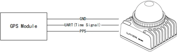

GPS Time Synchronization
GPS receivers output PPS signals strictly aligned with UTC seconds pulses. Other devices capture PPS rising edges via hardware interfaces (GPIO, TTL) and use this hardware pulse as a time reference to correct local clocks or triggers.

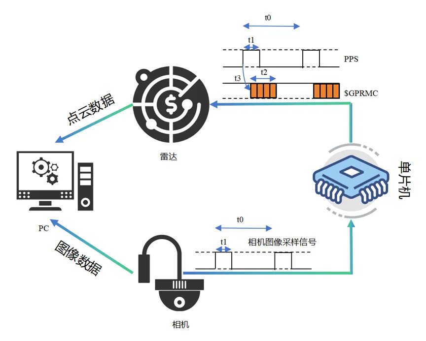

Taking a four-camera system and Livox Mid-360 LiDAR as an example, we first test whether camera and radar data timestamps remain consistently synchronized within a stable range.
Synchronization Method
According to radar and camera specifications, both devices support hardware synchronization. Radar synchronization utilizes UART with specific pin signal requirements. To simultaneously meet radar and camera hardware triggering, STM32 microcontroller generates pulse signals.
Testing Steps

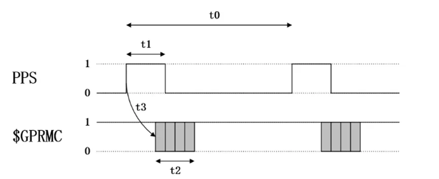

  • Configure camera for equal-interval sampling, producing pulses received by STM32 and converted into 1Hz synchronization signals (1PPS).
  • STM32 configures radar and camera hardware triggering requirements, connecting corresponding pins to radar and camera hardware trigger ports.
  • The test trigger frequency is 10Hz; intervals are defined by t0 (interval between consecutive rising edges of second pulses), t1 (high-level duration of second pulse), t2 (GPRMC transmission time), and t3 (GPRMC data transmission delay relative to pulse rising edge).

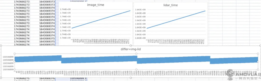

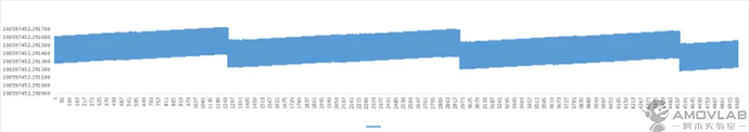

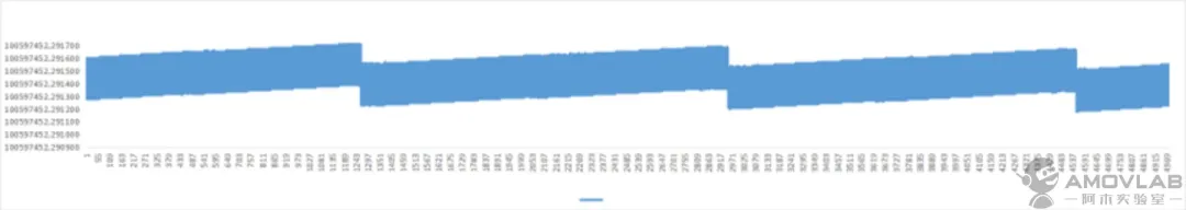

A test demo records timestamps of each frame from radar and camera, assessing synchronization success by analyzing convergence of their timestamp differences in UTC format.
Results show consistent convergence (Fig. a), with differences always under 1ms (Fig. b), indicating successful radar-camera synchronization.
