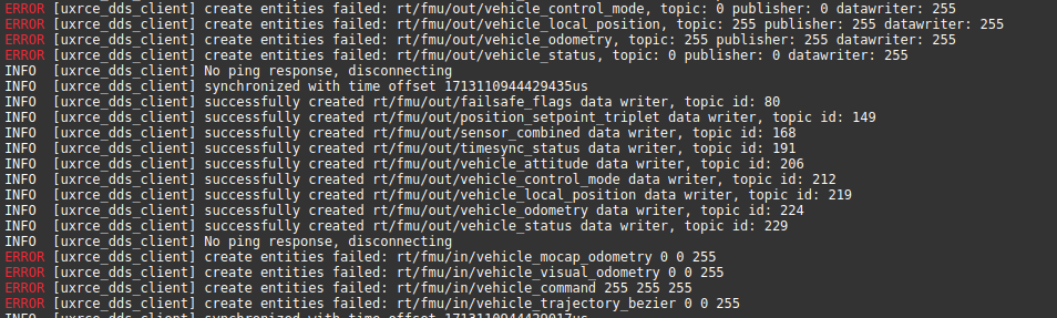

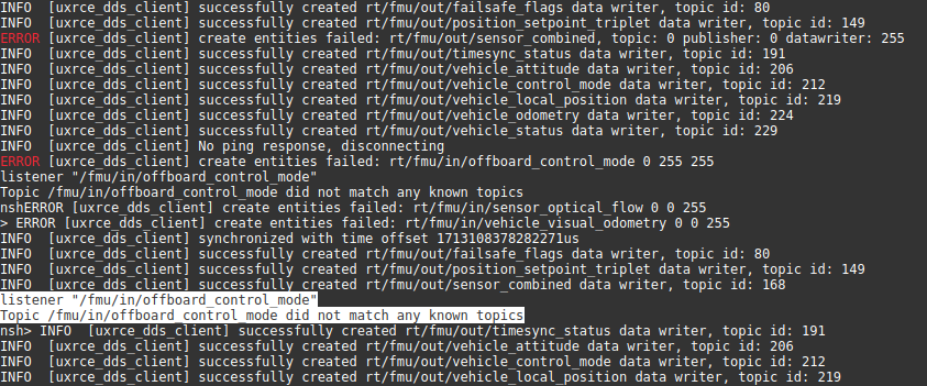

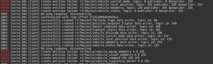

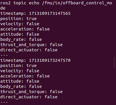

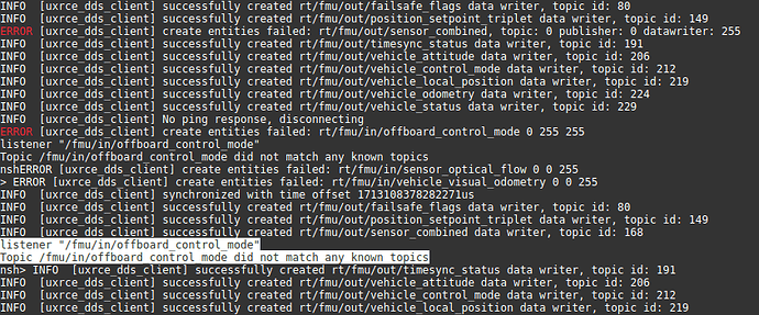

I am publishing OffBoardControlMode messages to the /fmu/in/offboard_control_mode topic on the Jetson. Unfortunately, nothing is picked up on the mavlink console (it does not even detect the topic). There is an error when the topic tries to get created (see attached images).
Jetson publishing and confirmed by echoing
There are several errors saying topics could not be created (including /fmu/in/offboard_control_mode). And I highlighted that the topic is not found.
Consistently get topic creation errors (even when I adjust baudrate).

Reviving the issue to add my experience. I had problem getting /fmu/out messages registered on MicroXRCEAgent (v2.4.3) in serial mode with Raspberry Pi 4 (ubuntu 22.04) and PX4 6C (v1.15). It turned out that error was low BAUD rate (57600 did not work where as 115200 did, as per @Benja 's suggestion).
I figured out after seeing this on nuttx terminal:
[timesync] RTT too high for timesync 11ms
Also, it does not work on emulated arm64 container as companion either. I suspect it has to do with emulation increasing RTT as well.
So do not assume that lower baud rate must be a better default value, trying multiple levels is apparently better.
uxrce_dds_client stop
uxrce_dds_client -t serial -d /dev/ttyS3 -b 115200
can be run on nuttx shell to manually restart the client for TELEM2. Cheers!
