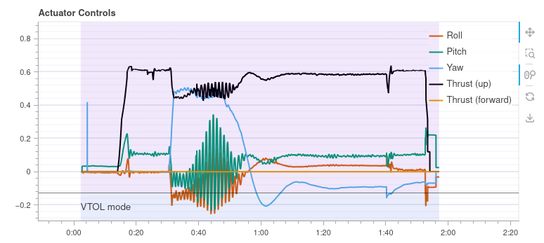

I recently worked on adding a custom model of a 25 kg VTOL in Gazebo Harmonic.
When I used the formulae for calculating the motor model parameters from the this pdf, the motors become overpowered. We achieve takeoff at 20% throttle.
When I use the formulas from the forum, we achieve takeoff at 60%.
I still don’t fully grasp these motor model parameters but upon some trial and error, the desired result can be achieved.
Hi. Do you adjust the motor parameters when you increase the weight? I suggest you open another thread and post it there along with a log file
Do you have any GitHub code that I can use and then continue the trial and error from there? Because I used the equations and no luck.
