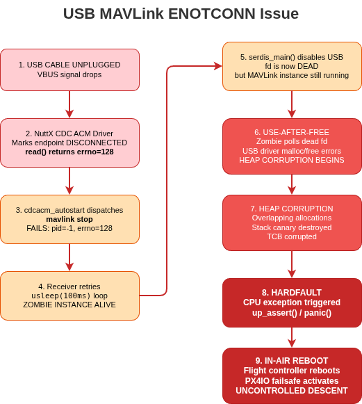

I had the same issue mentioned in the thread: Hard fault when switching comms link mentioned by @eagle_labs
Using v1.16.0 , I had debugged the root cause of this problem.
Issue:
  • cdcacm_autostart fails to stop the mavlink instance, creating use-after-free condition as @eagle_labs mentioned.,
  • mavlink_receiver.cpp line:3175, it just sleeps and retries the loop, causing the mem corruption.
Does any PR targeting this fix?
@JulianOes as you already part of this dicussion., I think we can move forward for this fix.

I added some PX4_INFO and PX4_DEBUG lines and found why mavlink fails to stop.,
INFO [cdcacm_autostart] VBUS present → absent (state=2 protocol=1)
INFO [cdcacm_autostart] connected: VBUS lost, requesting MAVLink stop
INFO [cdcacm_autostart] MAVLink stop: exec command on /dev/ttyACM0 (state_connected VBUS-lost)
ERROR 139083441 MAVLink stop: dispatch failed (pid=-1 errno=128 Transport endpoint is not connected)
DEBUG 139583615 state_disconnecting
INFO [cdcacm_autostart] USB disconnect: serdis_main() start
serdis: Disconnected
INFO [cdcacm_autostart] USB disconnect: serdis_main() done
errno=128 (ENOTCONN) proves the USB transport is already physically gone before cdcacm even tries to dispatch. exec_builtin can’t spawn the task because the endpoint is dead.
But Mavlink receiver already has ENOTCONN handling.
In mavlink_receiver.cpp line 3174
if (nread == -1 && errno == ENOTCONN) { // Not connected (can happen for USB)
    usleep(100000);  // just sleeps and retries forever!
Mavlink receiver detects ENOTCONN but never stops — it just sleeps 100ms and loops back. This creates a zombie mavlink instance on a dead fd.
Here is the complete picture.
  1. USB unplugged → CDC/ACM marks ENOTCONN immediately
  2. exec_builtin(“mavlink stop”) fails with errno=128 because transport is dead
  3. Mavlink receiver catches ENOTCONN but just sleeps 100ms and loops forever (line 3174-3176) — zombie!
  4. Instance slot stays occupied → stale pointer when USB reconnects → crash
I think we need to enfore mavlink stop instead of sleep and loop.,

Hi, With the changes mentioned in [BACKPORT v1.16] Try to fix potential mavlink segfaults on USB disconnect by julianoes · Pull Request #27727 · PX4/PX4-Autopilot · GitHub . It is having the same issue.
