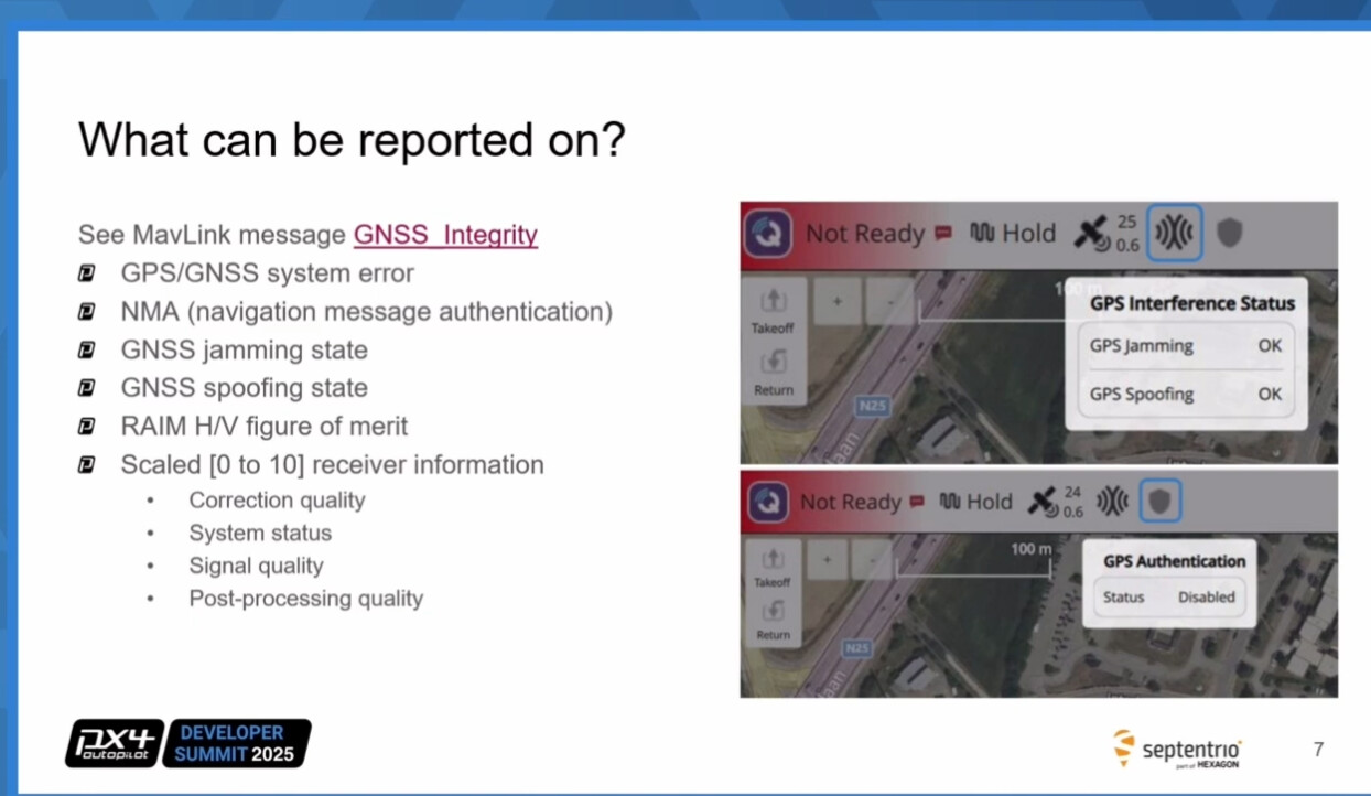

Recently saw the video about GPS jamming/spoofing Resilience Monitoring With State-of-the-Art Multi-Band GNSS Receivers - Kwinten Depestel, Septentrio and saw that there are two new options for EKF2_GPS_CHECK (Spoofing and Jamming).

E.g how can I get the symbol shown in the presentation?
GNSS_INTEGRITY is a recent message so I suspect it is on main only, and this is likely a QGC daily built. I’d try out that combination. The PR it was added in was Septentrio resillience reporting by Louis-max-H · Pull Request #25012 · PX4/PX4-Autopilot · GitHub. This looks like Septentrio so you’d need to get their hardware for whatever driver sets SensorGps (UORB message) | PX4 Guide (main).
