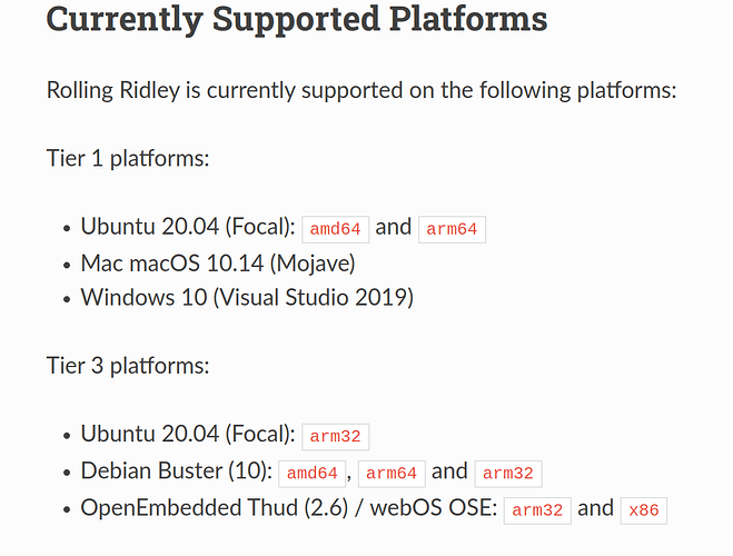

Here you mention that you are running 22.04, but the link you sent which you based your container on, states that it supports the ROS 2 Rolling environment, which according to this link, does not support 22.04 Rolling Ridley (rolling) — ROS 2 Documentation: Foxy documentation.
I am using this Dockerfile (based on the ROS 2 rolling container) which installs ROS 2 humble.
I also feel like this issue is independent of the ROS version installed though. Unless I’ve missed something, I feel like on a fresh Ubuntu install (in this case provided by the container with 22.04), following the setup instructions (i.e. running the ubuntu.sh setup script) should suffice to enable building PX4?
