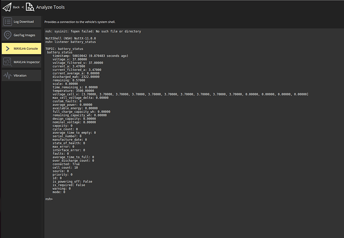

I’m encountering an issue with sending BATTERY_STATUS. It seems that the extension fields (time_remaining, ChargeState, VoltagesExt, Mode) aren’t reflecting in QGroundcontrol. Do you have any suggestions on how to solve this problem so that they’re properly displayed in QGC?
I have an external BMS that is sending these common.MessageBatteryStatus.

  • All these Values are reflecting in QGC battery Bar (id, battery_function, type, temperature, voltages, current_battery, current_consumed, energy_consumed, battery_remaining)
  • These values are not reflecting even if I am sending (time_remaining, charge_state, voltages_ext, mode, fault_bitmask), These Values are marked in blue and they are extension field of MAVLink V2 lib.
  • As I am using a 14s battery and time_remaining is critical to RTL, all these fields are important for my project.
I’m so confused. PX4 supports MAVLink v2. If you want to force everything MAVLink v2, just set MAV_PROTO_VER to 2.
Still I am not receiving anything after changing MAV_PROTO_VER to 2.
After changin to V2… rebooted the Vehical
First of all, PX4 Autopilot supports MAVLink 2; I’m sure that’s not your issue here.
I have a few questions for you
  • What version of PX4 are you running?
  • Can you talk about your setup?
    • How are you connecting your BMS to Pixhawk?
  • When and how are you running the script you posted above?
