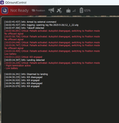

I am publishing at /mavros/setpoint_position/local at 50Hz. I have no data link lose no RC lose as soon vehicle armed and takeoff offboard switching to position and offboard rapidly
QGC shows Failsafe activated, but no such failsafe exists.
logs attached below ![]()
