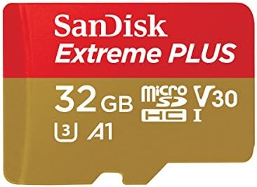

The quality of the SD card is very important (more if you are using “High rate”) if you don’t want to have any data dropout. I recoment you to use quality SD cards (no more than 32Gb) like SanDisk Extreme o others. I recommend not to use the default memory card that comes with the auto-pilot.
The memory of the card is not going to be a problem with 2-3 mins logs.
