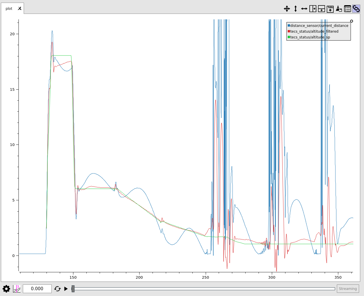

As I can see, the output of the EKF is following the setpoint and the regulation of the altitude is perfect. (but setpoint is 1.1m and the mission plan 1m)

  • EKF2_HGT_MODE : Range sensor
  • The gate, delay and noise are as default
Here is the logfile:
https://logs.px4.io/plot_app?log=3f074f95-e6e9-459e-a657-904be020a25d
I don’t understand why the plane crash if the EKF output is following the setpoint. When I compare the sensor output and the EKF Output, it’s like the EKF is not using the sensor.
My objectif is to have an altitude regulation with 10 cm accuracy above a flat surface. I want use the sensor as primary source for altitude measurement.(maybe the only one).
Please someone can give me advices or tell me some error I’ve made ? :slight_smile:
