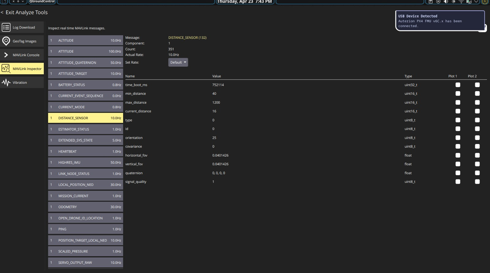

if i check in the mavlink inspector in the distance sensor the values are good and changing accordingly …

Pixhawk 6C port usage described by user:
this is my current status:
In mavlink console:
listener distance_sensor
listener vehicle_local_position
Output:
current_distance: 0.14 m
min_distance: 0.40 m
signal_quality: 0
dist_bottom_valid: False
what i interpreted:
TF02 was detected correctly
  1. But measurement < min_distance (0.4 m) → PX4 rejects it
  2. Result:
    dist_bottom_valid=false
    No height fusion at low altitude
    Rangefinder was not the problem, but **operating below valid range caused rejection
