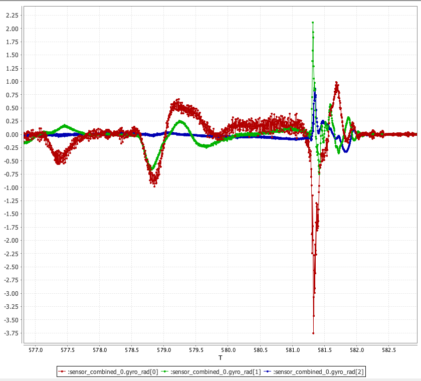

Looking at the data there is evidence the IMU experiences some internal aliasing or clipping starting at 578.5 seconds.

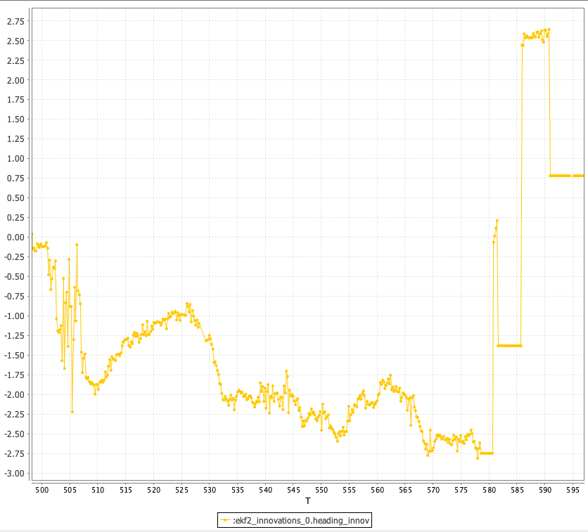

The EKF builds up a large magnetic heading innovation (inconsistency between magnetometer and inertial nav) immediately after takeoff
This is due to extremely high levels of magnetic interference, making the magnetometer completely unusable, eg:
This resulted in the magnetometer data being rejected by the EKF shortly after takeoff, however that meant it was having to inertially dead-reckon yaw for the remainder of the flight. After 10 minutes the accumulated error was enough to destabilise the EKF. If yaw error build sufficiently, then GPS velocity and position which are in earth frame cannot be used to correctly correct for Roll/Pitch error that accumulates in the inertial nav.
In summary the loss of attitude reference was caused by incorrect integration of the autopilot. However, given the EKF was broadcasting the problem via the estimator_status message, which shows the mag_test_ratio above 1 (failed magnetometer), for over 9 minutes prior to the crash, the SW deficiency in this instance is a failure to notify the operator.
