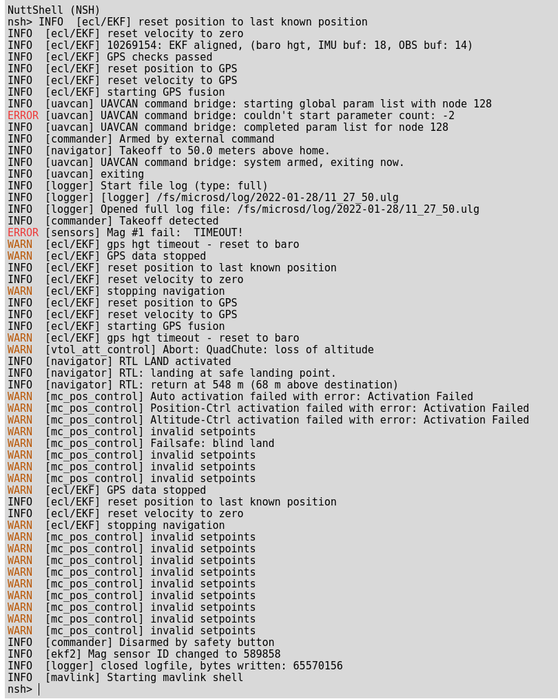

We have some logging dropouts, so flight review does not include all messages. Here is the output from dmesg:
Any input on the PWM output stopping or tips for troubleshooting would be welcome.
