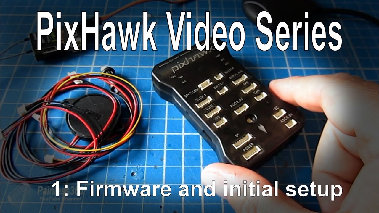

Why dont you do like this ? Check the video of painless360 (after 18minutues):
Other equipments in drone affect magnetic field of compasses.
