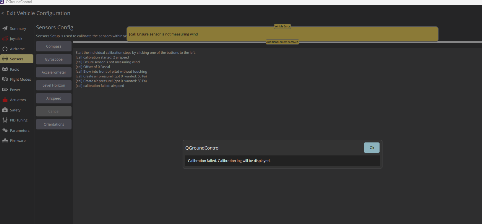

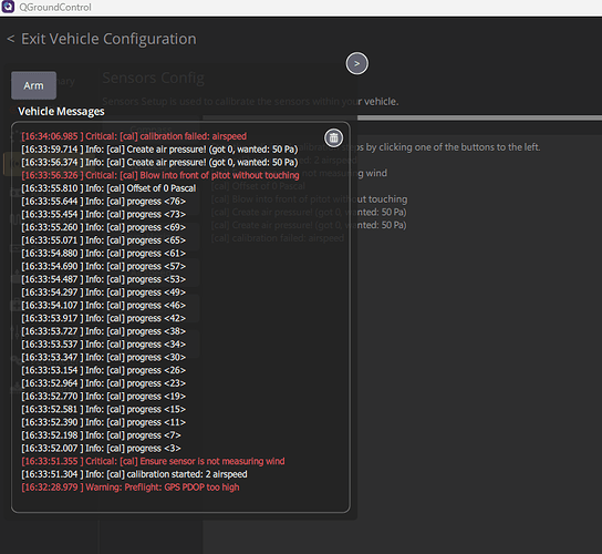

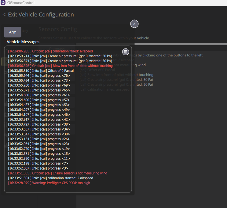

I then go to Sensors→Airspeed and click on Airspeed. I don’t touch the pitot tube until it tells me to blow into it, front only. I do this and it fails. It fails if I switch the tubing, it fails no matter what I have tried.

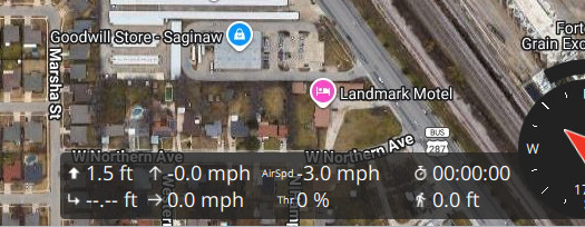

It is also reporting negative airspeed and is showing -3.0 mph instead of zero mph.

Swapping the tubing has solved the negative airspeed problem, “zero” is still showing as -3.0 mph. I do not trust the calibration procedure or the reported airspeed that shows up when I blow into the tube.

I assume the “zero” is also fluctuating a bit? This is expected with most sensors and will not harm your performance.

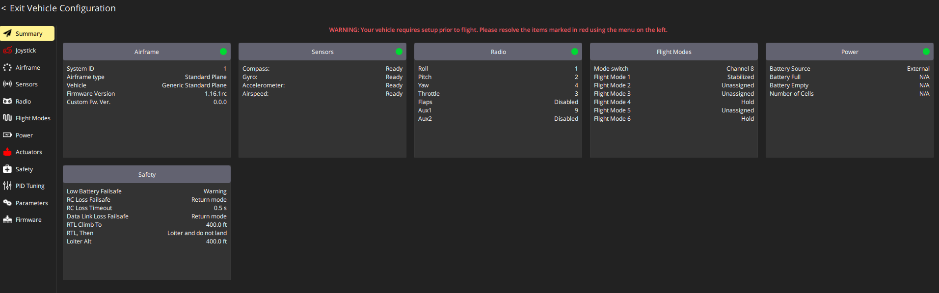

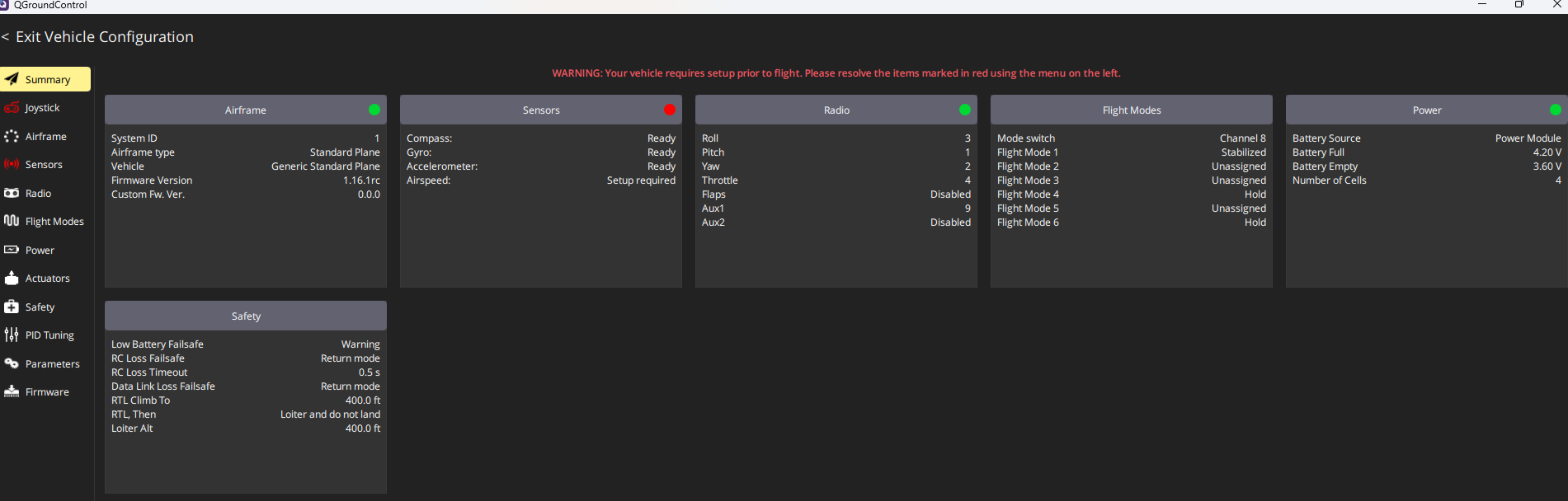

And now I see that the airspeed sensor is reporting that it is not calibrated BUT I HAVE DONE NOTHING BUT RECONNECT to it!

Marking this as tentatively solved. Turned out one needs to blow into the front (dynamic) end of the pitot tube HARD. You have to push enough air to hit the upper sensing limit, in the SDP3x case that’s 50 Pascals of pressure. Not sure if the calibration is correct though as its resting mph is bouncing betweent -3 and +3mph. It should be a SOLID ZERO mph bouncing NONE AT ALL. We will see. :frowning:
Ah, yes, forgot to mention that. Its expected that you have to blow pretty hard :slight_smile:
Its expected to bouce in low numbers, if you do not have an extremely expensive airspeed sensor (100s or 1000s of dollars). So all good to go.
