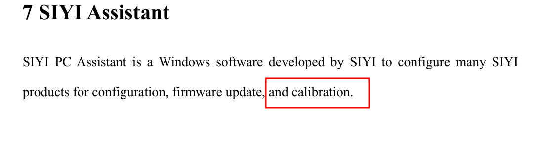

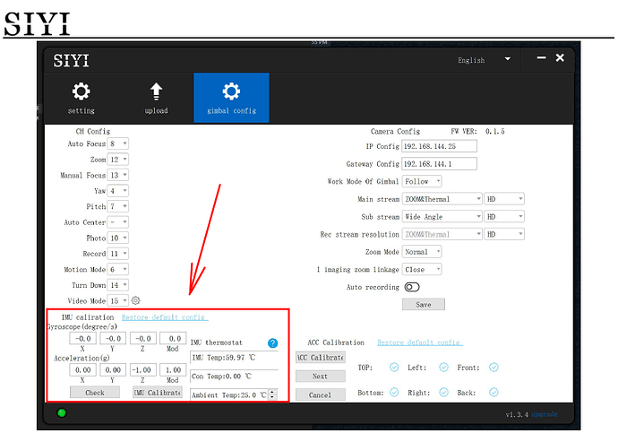

This actually sounds like a fundamental hardware/SIYI control problem.
@tanaka_hiro
Have you calibrated gyros as per camera instructions?
In manual docs of ZR30 I can’t find any instruction for calibrated gyro. Where I can find these instructions ?
It is not specifically explained, only referenced:
SIYI User Manual v.1.6
Page 128
Also on page 40:
