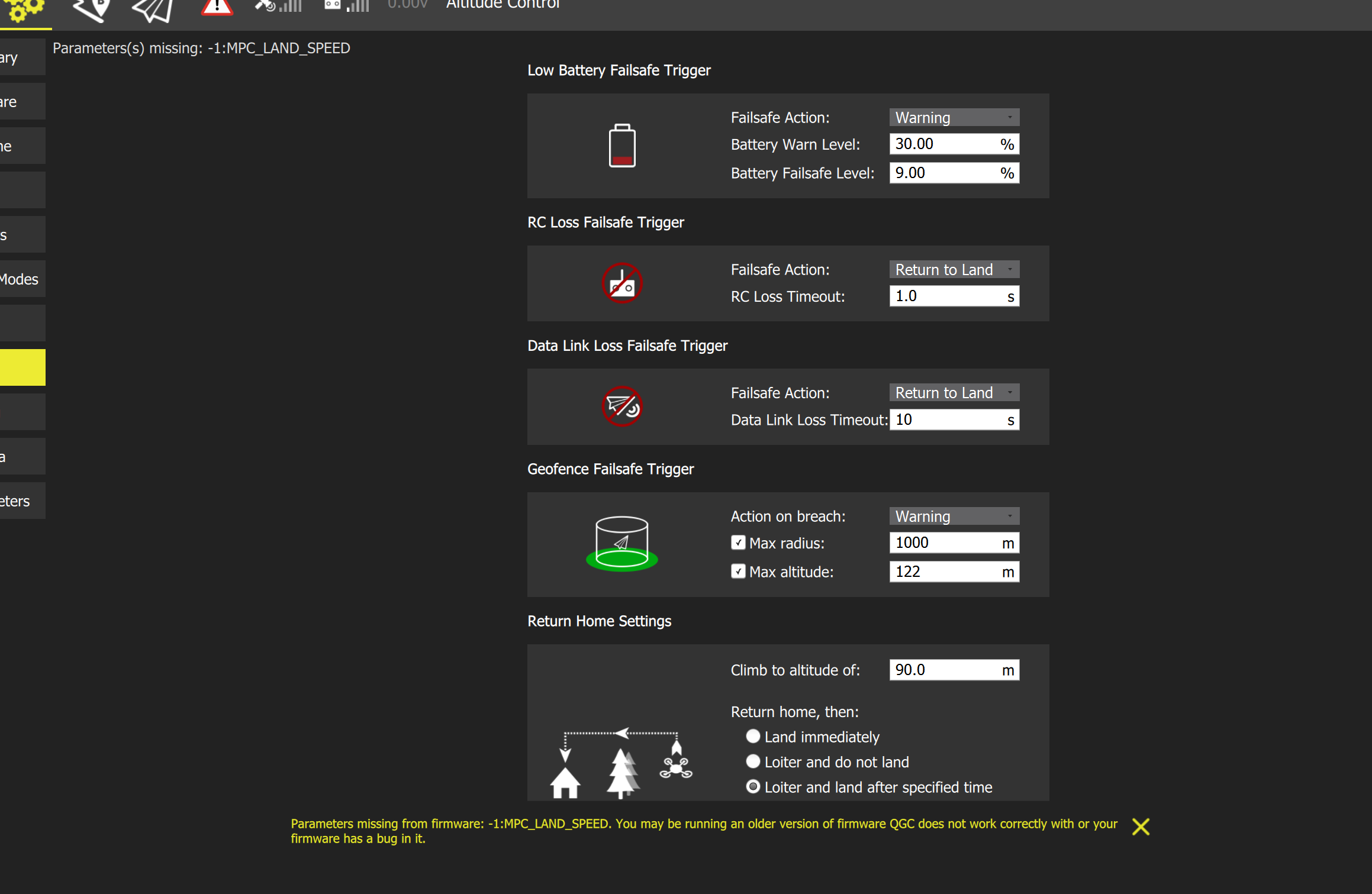

i found this issue with the beta build of px4 and the daily build of qgc.
also found this issue missing parameter on phantom wing.

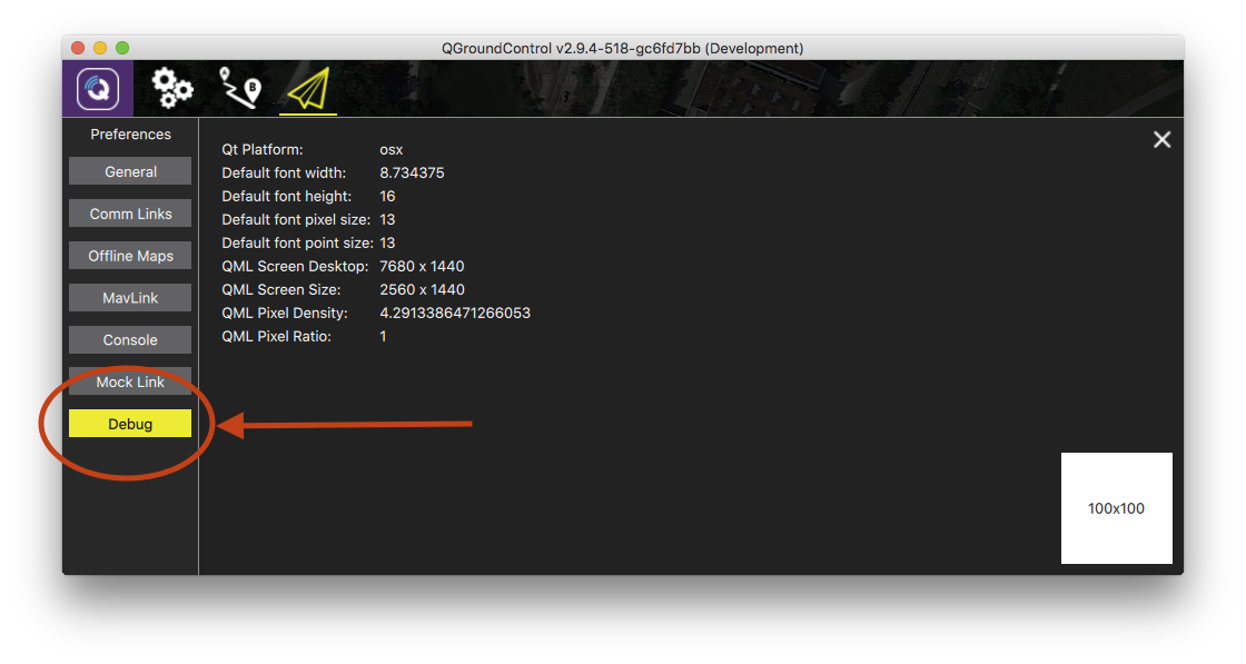

The summary issue is a layout issue with the summary controls. Based on the screen capture, it seems the control is too small or the font is too big. There are still quite a bit of cross-platform layout issues in QGC. Could you do me a favor and send a screen grab of the “Debug” panel (under “Preferences”)? That will help determining what your system thinks your screen density is. So far I have not been able to find a constant across platforms.
The missing “MPC_LAND_SPEED” means just that. QGC expects that parameter and it’s missing.
Lastly, when you change the camera trigger mode and hit “Apply”, it reboots the flight controller. QGC “should” show a disconnected state and reconnect automatically once the flight controller comes back online. If it’s showing a white screen on Windows, it’s a bug in the Windows version (which I have not tested at all).
I’ll get the screen shot for you. Is the missing parameter a big deal? The camera restart is definitely a bug. The layout issue may be because I am using a surface pro 4?
I meant the “Debug” panel, not the Console :slight_smile:
How do I get that tab. Mine stops at console

Yes, I guess that computer of yours is under the “Tablet” category, which is where we really need to figure out a way to have it consistent across platforms :slight_smile:
Oops… You need the debug version for that. I assumed you were building it yourself.
No I just have the daily builds. @dogmaphobic I can confirm the layout issue on a regular laptop with 1080p display as well…
