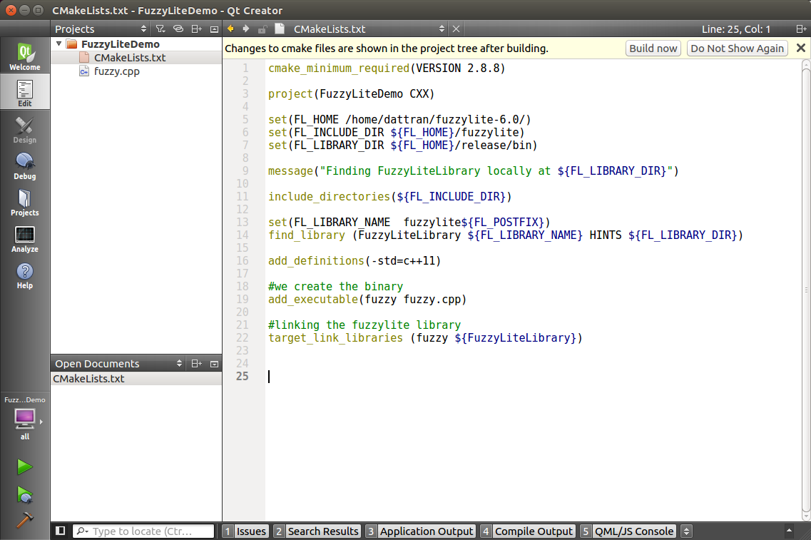

First, I’ve built a standalone project using Cmake to link it with fuzzylite, the CMakeLists are below
and the program has run well.

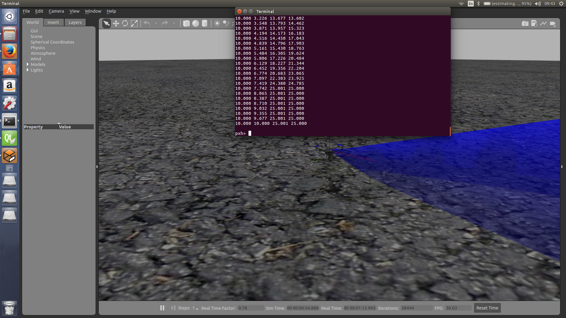

This is the fuzzylite example I ran on posix_sitl_default
