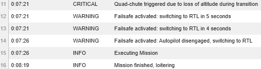

My PX4 v1.15 drone indefinitely loitered at the mission landing loiter point instead of continuing to land during RTL. We had to take over control and land it manually, but this is potentially disastrous behavior. It should have landed because RTL_TYPE = 2 and there was a mission landing planned.
It had these messages:
I have not been able to replicate this in SITL by triggering a quadchute nor switching to Return mode. I’m not sure how to get the “Failsafe activated: Autopilot disengaged, switching to RTL” message either.

I believe you are referring to the FW_LND_USETER parameter. However, since this is a VTOL drone, that parameter does not apply. As far as I know, there is no equivalent parameter for VTOL. And there was no indication in the logged messages that it wasn’t landing due to a parameter exception like that.
