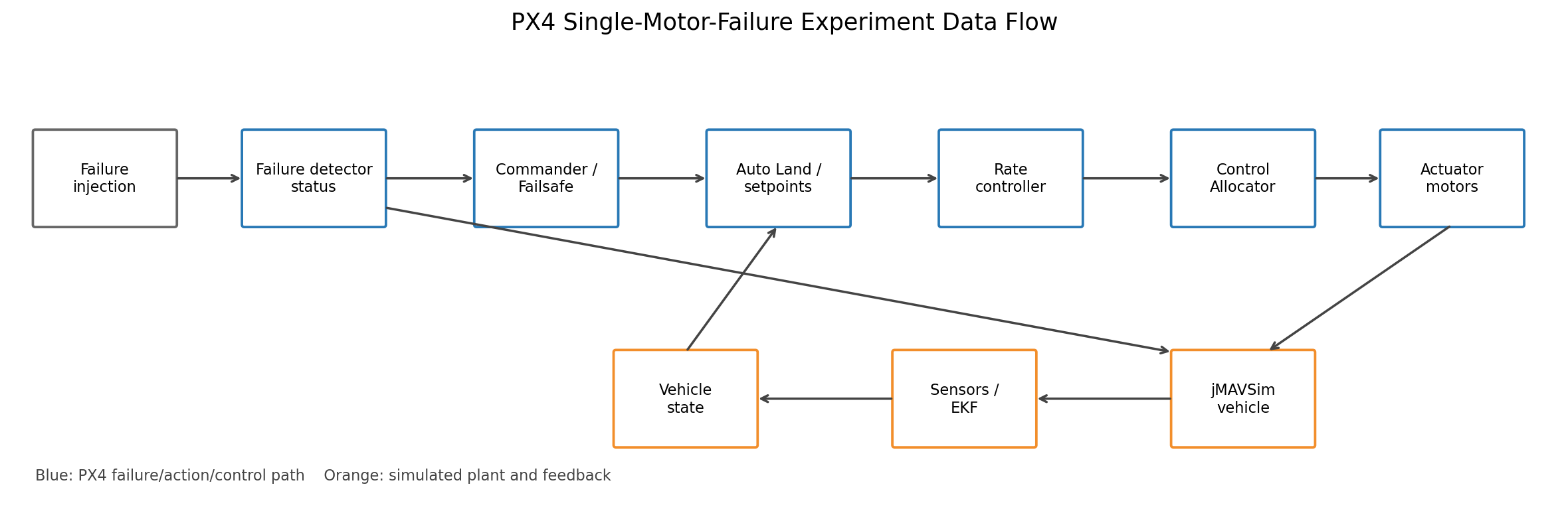

2. The modified failure-handling path
The complete data flow is shown below:
2.1 Feed an injected stopped motor into the failure path
PX4 failure injection produces a motor_stop_mask. With the experimental
change, the Commander failsafe flag reports a motor failure when either
fd_motor or motor_stop_mask is non-zero:
fd_motor_failure = fd_status.fd_motor || fd_status.motor_stop_mask != 0;
This addresses a mismatch in which the simulator had already stopped a motor,
but the failsafe and control-allocation paths did not use the same failure
source.

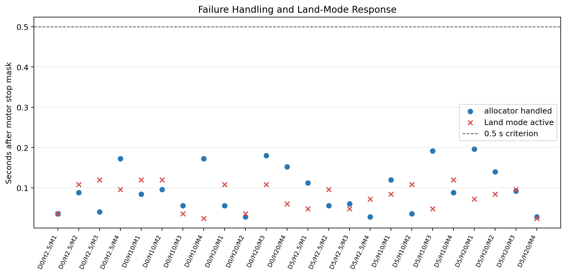

7.1 Failure-path results
Across the 24 formal ULogs:
  • correct handled-motor mask: 24/24;
  • finite allocator reporting: 24/24;
  • stopped failed-motor output: 24/24;
  • maximum allocator handling response: 0.196 s;
  • maximum Land response: 0.120 s;
  • strict matrix validation: errors: [].
Response-time distribution:
At the software-path level, a stopped motor reaches Control Allocator and
Commander quickly and triggers the expected degraded Land behavior.
COM_FAIL_ACT_T=5 s does not add a five-second delay to this path.

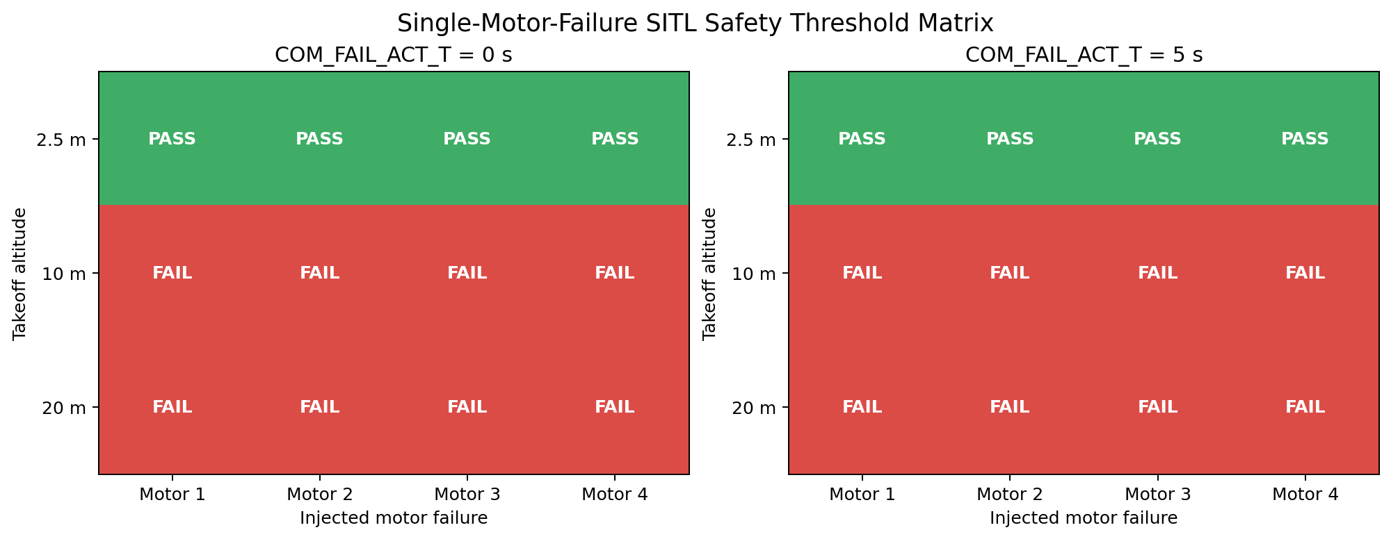

Matrix heatmap:
The result shows:
  • all eight 2.5 m cases satisfy the experimental thresholds;
  • all eight 10 m cases naturally disarm but violate at least one dynamics
    threshold;
  • all eight 20 m cases violate at least one dynamics threshold;
  • both Motor 4 cases at 20 m fail to produce a touchdown observation within
    90 seconds and are force-disarmed by the runner.
“Natural disarm” only means PX4 eventually entered the disarmed state. It does
not prove that the impact was safe.

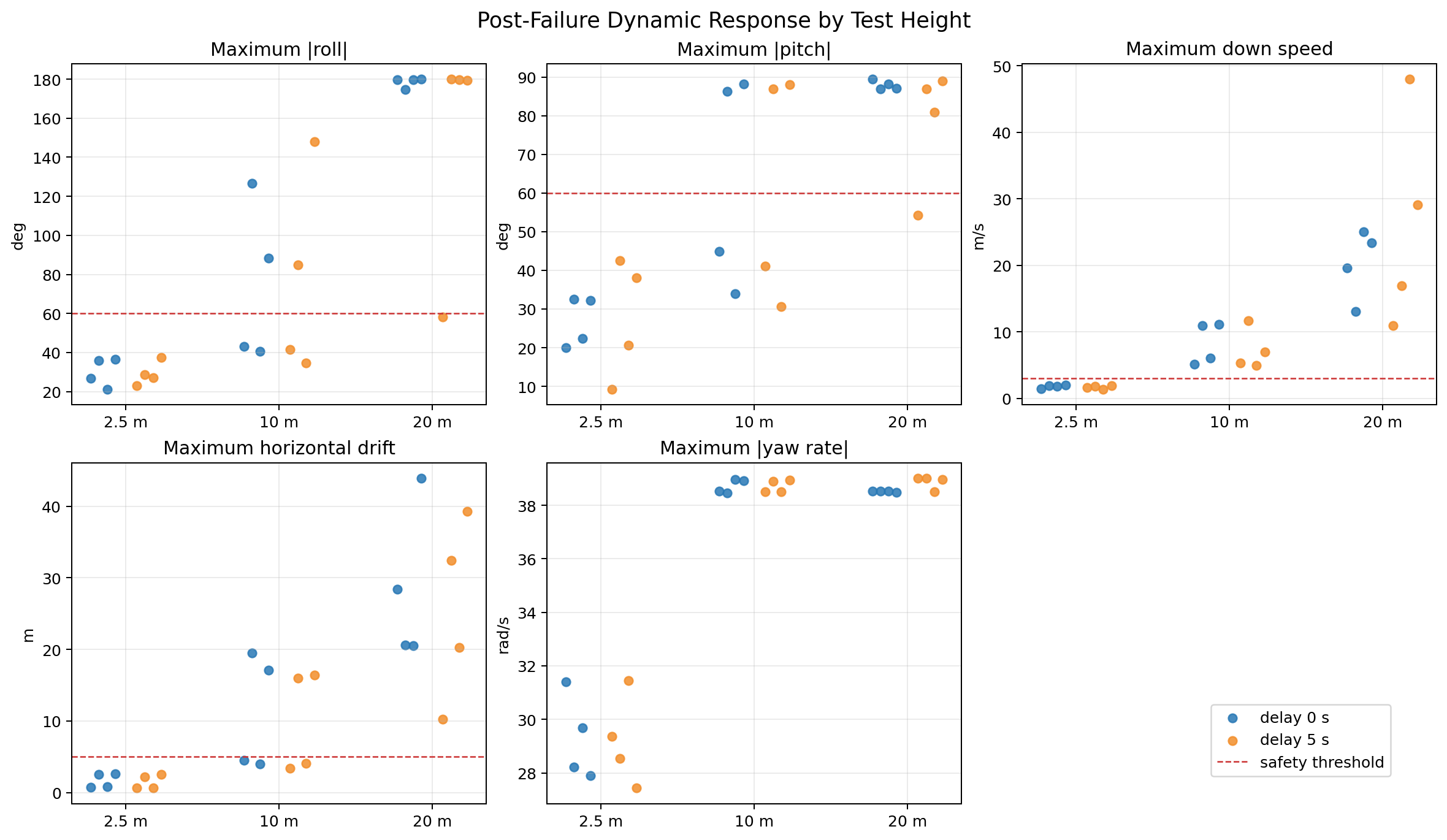

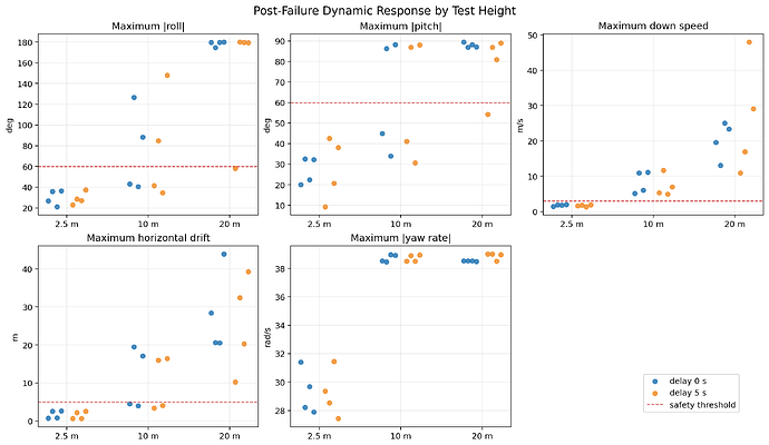

7.3 Effect of altitude on the dynamics
The extrema observed over the complete matrix were:
  • maximum down speed: 47.980 m/s;
  • maximum horizontal drift: 43.940 m;
  • maximum absolute roll: 179.935 degrees;
  • maximum absolute pitch: 89.469 degrees.
The numbers of cases exceeding each dynamics threshold were:
  • down speed above 3 m/s: 16;
  • horizontal drift above 5 m: 12;
  • absolute roll above 60 degrees: 11;
  • absolute pitch above 60 degrees: 11.

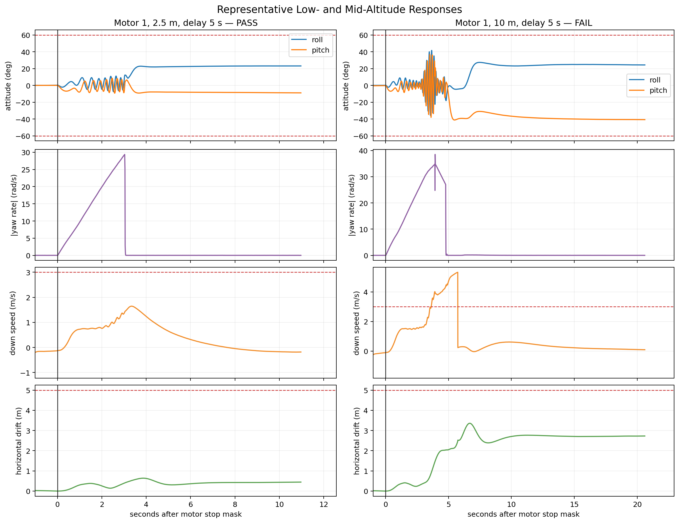

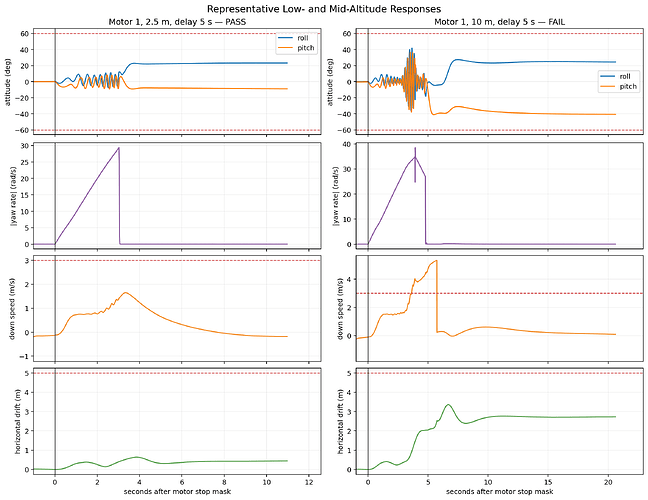

The following plot compares one low-altitude pass with one mid-altitude
failure:
Degraded three-motor control does not create a new control degree of freedom.
At greater altitude, the vehicle has more time to accumulate yaw rate,
attitude error, horizontal velocity, and down speed, and can eventually flip
or drift a large distance.

9. Current limitations
  1. Only jMAVSim SITL has been validated.
    ESC saturation, motor inertia, arm flexibility, structural impact, battery
    voltage sag, and real aerodynamics are not represented adequately.
  2. Real failure detection has not been validated.
    The experiment stops a motor through MAVLink injection and focuses on the
    handling path after the failure flag exists.
  3. The yaw-torque limit is a hard-coded experimental value.
    There is no cross-airframe tuning basis for 0.15.
  4. Only the first single-motor failure is handled.
    Multiple-motor failures are outside the scope of this implementation.
  5. The higher-altitude results are unacceptable.
    No 10 m or 20 m case satisfies all dynamics thresholds.
  6. The added test sources have not all been executed.
    The local environment lacks the test/fuzztest submodule and MAVSDK C++
    3.11.2, leaving the added failsafe_test and MAVSDK targets with a
    validation gap.
  7. The implementation is not specific to Flycore.
    The changes are in the generic Commander, Flight Mode Manager, Rate
    Control, and Control Allocator paths. Any quadrotor enabling the same
    parameter combination may enter this experimental logic.
10. Questions for the community
I see this experiment as a starting point for discussion, not as a finished
feature. I would especially appreciate feedback on the following questions:
  1. After a single-motor failure, should the controller release heading
    completely, or operate in a dedicated spinning reference frame?
  2. Should the degraded yaw-torque limit be parameterized, or computed online
    from the remaining control authority?
  3. Is Land the right action for a quadrotor, or should PX4 introduce a distinct
    controlled-descent mode?
  4. Which Gazebo or real-motor models are most appropriate for validating this
    high-yaw-rate state?
  5. What is the minimum failure-detection, HITL, and safety-cage test set that
    should be completed before considering real hardware?
I welcome independent reproductions, commit reviews, analysis of new ULogs,
and suggestions for a more appropriate control strategy.
