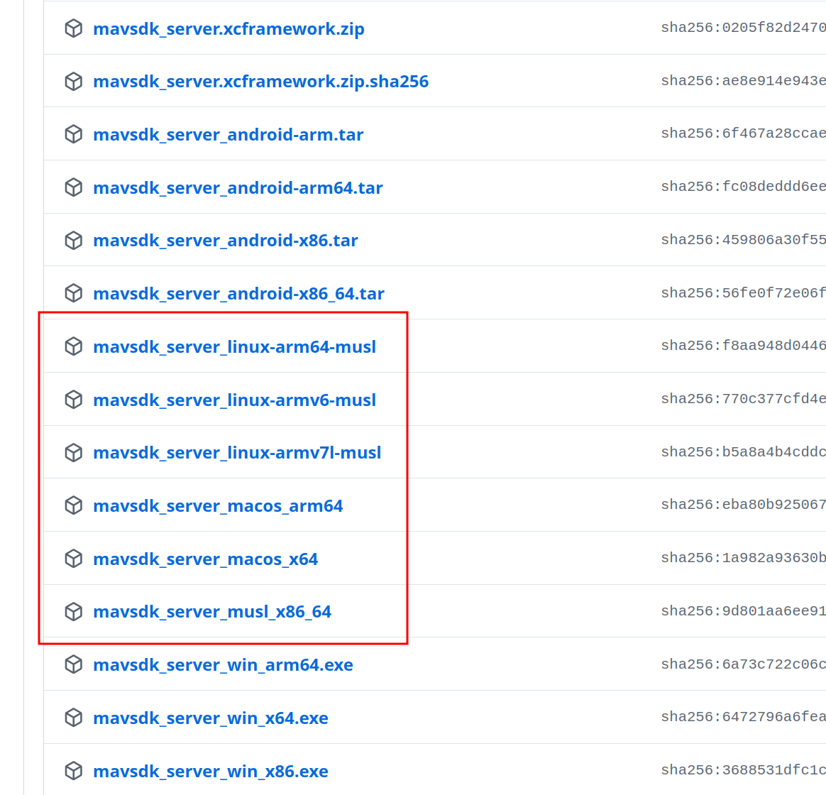

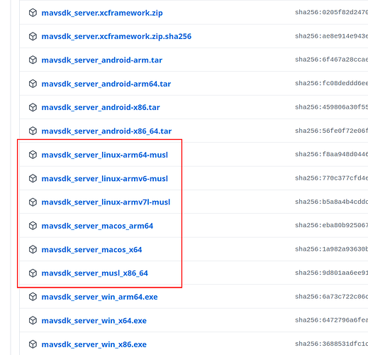

The main option to add to the cmake configure line to build with the mavsdk_server is -DBUILD_MAVSDK_SERVER=ON
However, I usually recommend to just grab the latest pre-compiled release unless you have changes in a fork. You can get the build artifacts for the releases here: https://github.com/mavlink/MAVSDK/releases.
There are various options. For docker x64, you can just grab the musl one, which doesn’t even require libc, everything is built in. (It’s what we ship with pip.)
