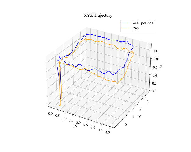

In the third stage, we used vision position as the horizontal position source and range sensor as the altitude position source; GPS was completely disabled. Two different methods were used to pass visual positioning data to PX4:
Way 1: Broadcast TF tree.
①We modified the ‘vision_pose_estimate’ part in ‘px4_config.yaml’: Change ‘listen’ from ‘False’ to ‘True’. Set ‘frame_id’ as ‘map’. Set ‘child_frame_id’ as ‘base_link’. (‘map’ is the local ground coordinate system, ‘base_link’ is the body coordinate system.)
②We wrote a ROS node to broadcast the TF tree:
③Based on original parameter settings, we set parameters related to visual positioning, which include EKF2_GPS_CTRL (0), EKF2_EV_CTRL (13).

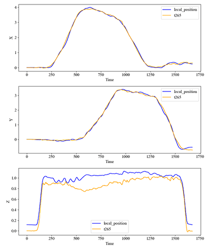

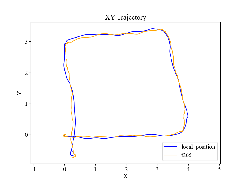

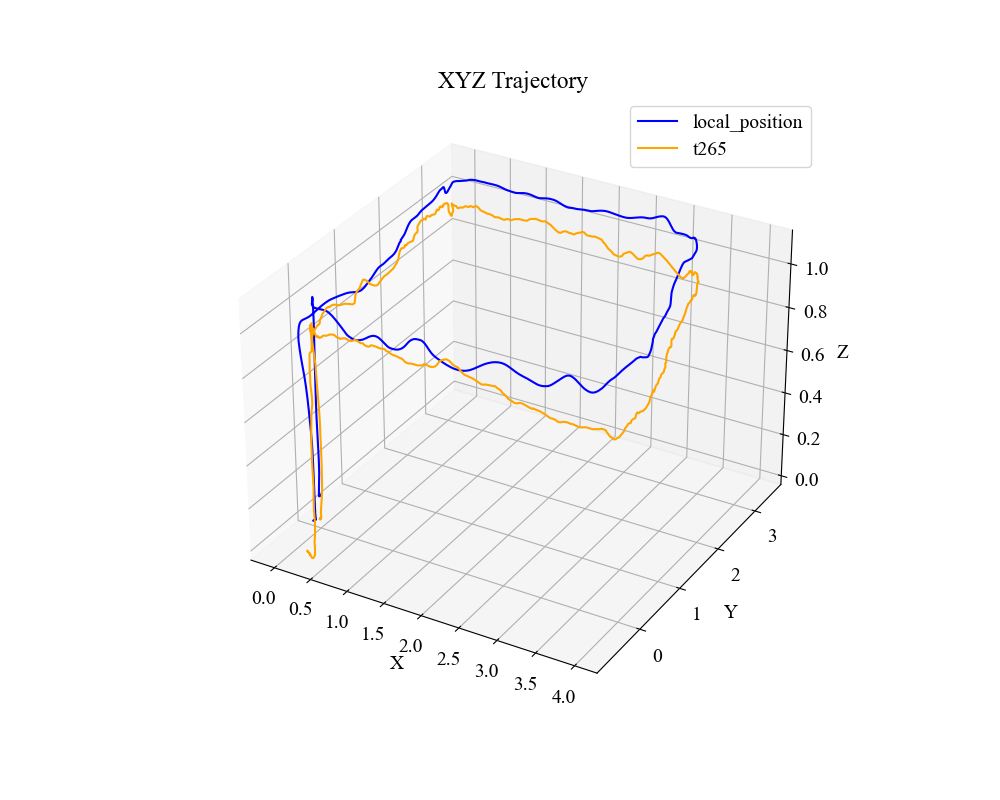

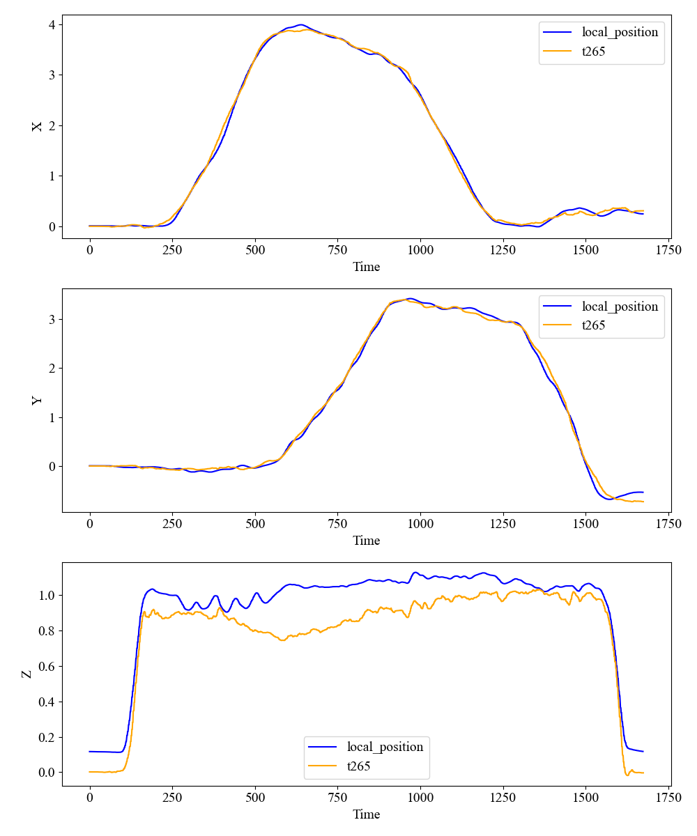

④After powering on the UAV, we lifted the UAV by hand and walked around to simulate flight to test the result of visual positioning. We recorded ‘local_position’ data in real time, published by PX4, and compared it to the data in ‘camera/odom/sample’ published by the camera. Although as the real position to the original point increased, the position error increased, the changing trend of positioning was consistent with the actual route taken, which showed that the coordinate system transformation in the TF tree was correct, and the positioning error in the original point was so small that it can be ignored. The test results were as below:

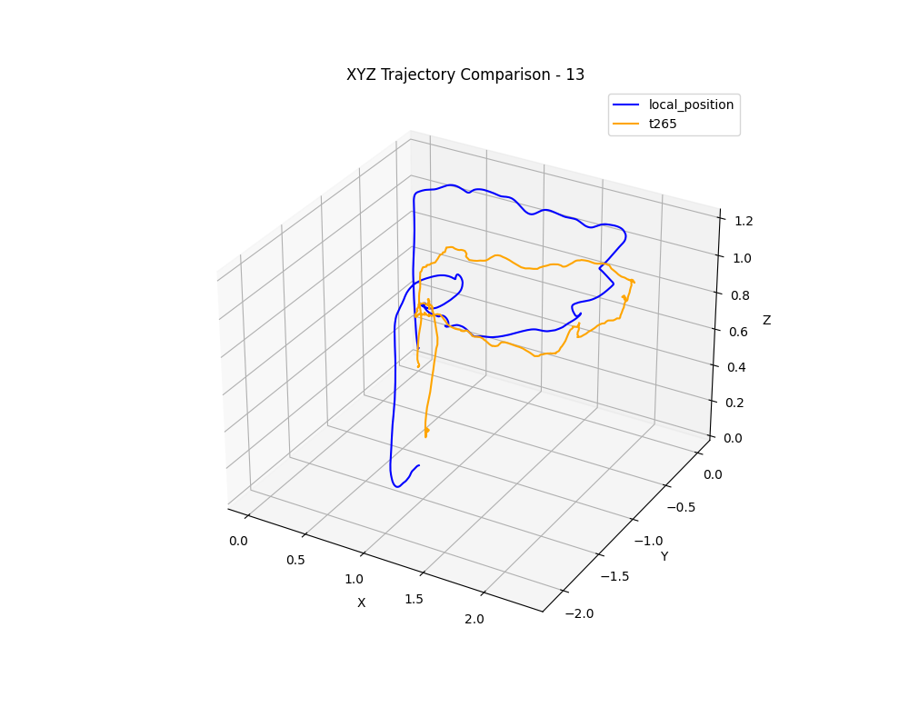

Way 2: Publish topics.
①We modified px4_config.yaml, ‘vision_pose_estimate’: Change ‘listen’ from ‘True’ to ‘False’.
②We wrote a ROS node to publish positioning data to ‘/mavros/odometry/out’ and publish System status messages to ‘/mavros/companion_process/status’. We also changed the parameters related to camera location in ‘bridge.launch’. The document we refer to is:
https://docs.px4.io/main/en/computer_vision/visual_inertial_odometry.html#suggested-setup
The code is as below:
③Same as the one marked as ③ above.

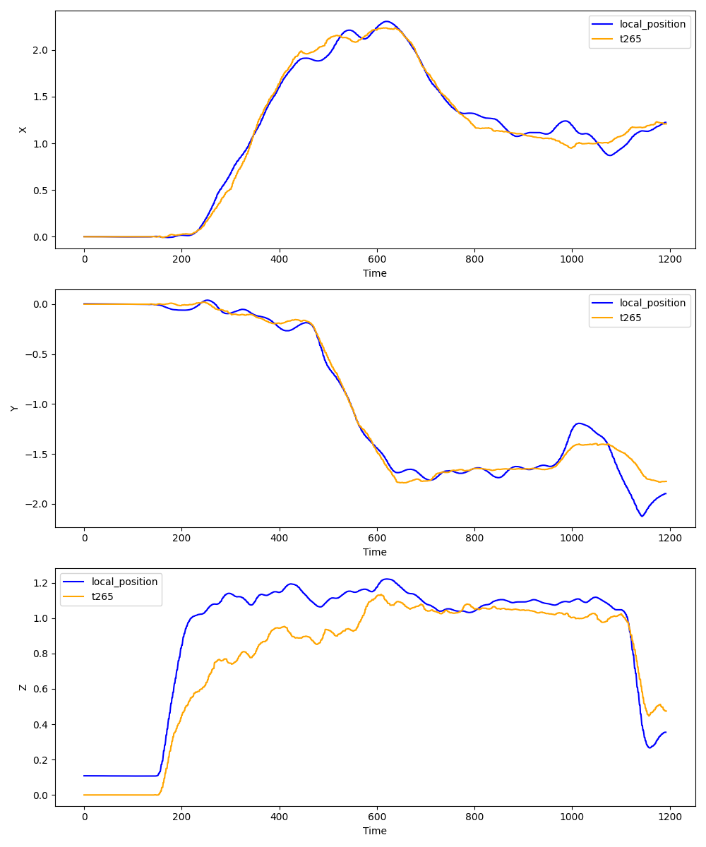

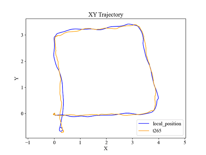

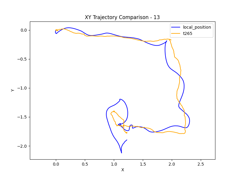

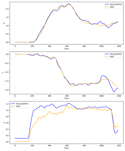

④Same as the one marked as ④ above. The test results are as below:

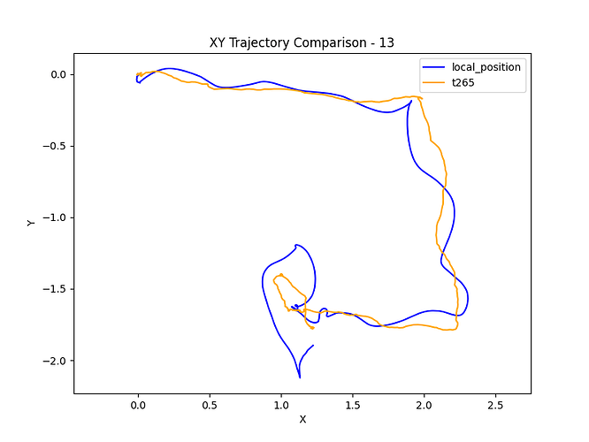

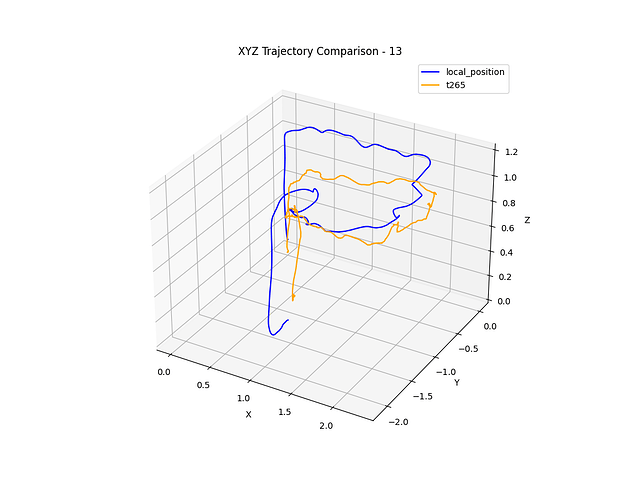

⑤We tried to control the UAV to take off and hover using a remote controller in POSITION mode, but after taking off, the UAV couldn’t hover at the origin; it would move in a random direction from slow to fast, and then lose control. The pilot doesn’t move the stick after taking off. We try many times, but the result is similar. Below are .ulg files recorded:
Use visual positioning, lose control of the UAV:
