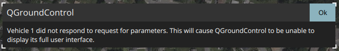

* Even this is only partially working as I don’t see any info under Vehicle Setup in QGroundControl, and a few seconds after connecting, I get this error every time:
