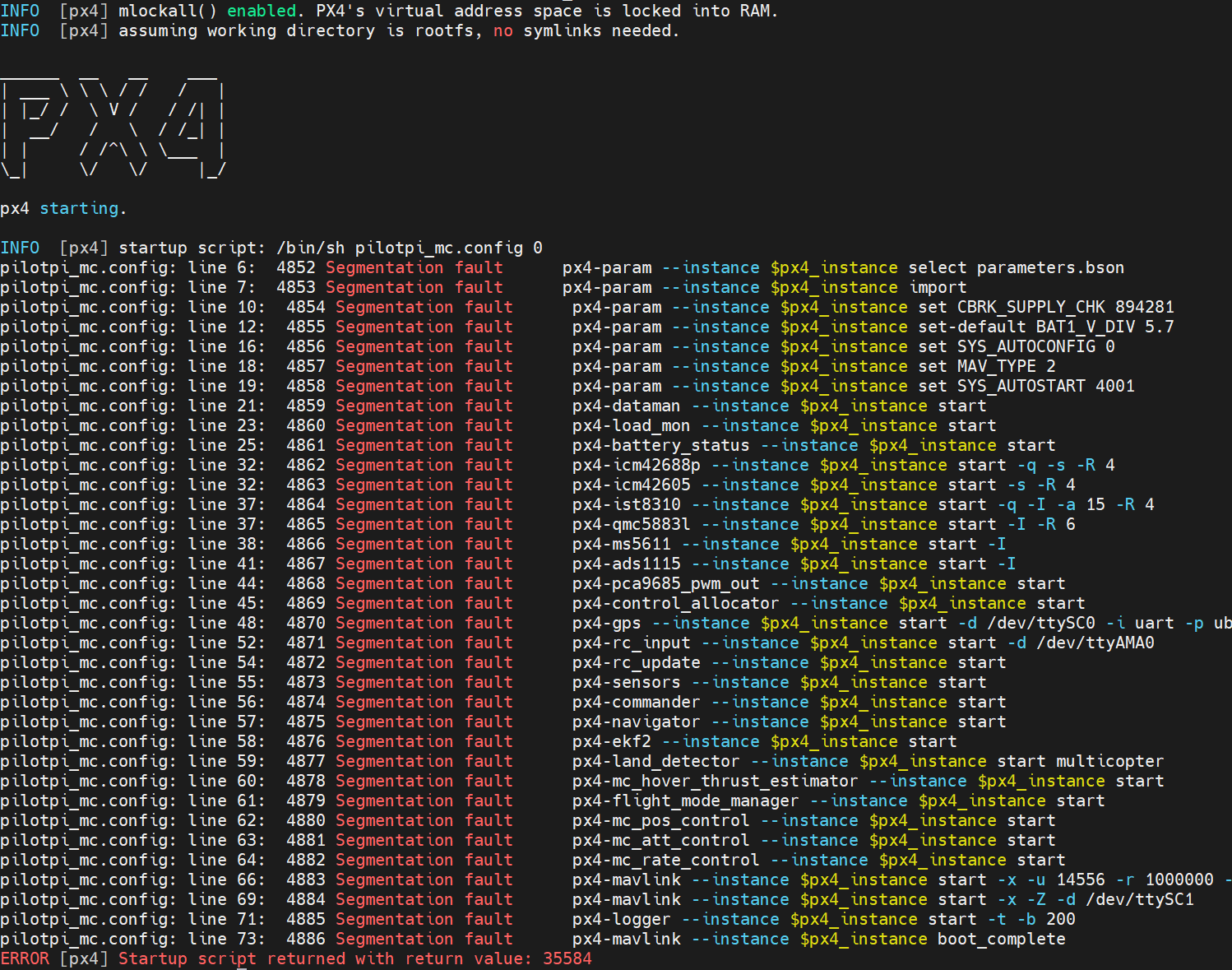

I’m currently working on porting the px4_raspberrypi_default firmware to a Rockchip RK3588 board. I successfully cross-compiled the code using my own toolchain without any errors.
However, when trying to run the generated binary on the RK3588 board, I encountered a segmentation fault , as shown in the screenshot below:

Well, first thing I’d do is start it using gdb and get a backtrace, or alternatively use something like coredumpctl debug to get the latest backtrace from coredump.

I’ve finally figured out the issue — it turns out not to be related to the platform at all, but rather a silly mistake I made when transferring the program to my device.
Since I didn’t have the rsync tool installed on my RK3588 board, I manually copied the executable files from the server to the device using a Windows PC. Unfortunately, this method broke the symbolic links between the “px4-*” files and the main “px4” executable.
The problem was resolved once I switched to using tar for compression and transfer — everything now works perfectly on the RK3588.
