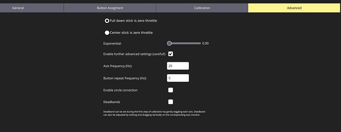

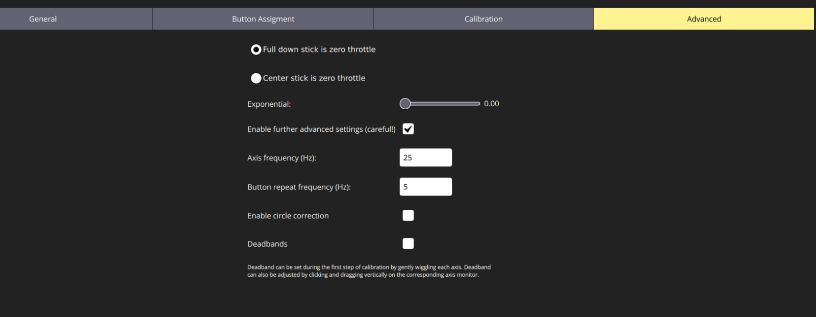

The option in Joystick to configure Gimbal Control Enable Gimbal Control isn’t really there when I searched for it (link says it should be there but I couldnt find it - see screenshot)

First step is to set it up correctly in PX4, you can test it using gimbal status and gimbal test pitch -45 in MAVLink shell. Then make sure MNT_MODE_IN is gimbal v2.
@JulianOes Assuming I’ve done the setup correctly, how do I configure the joystick for gimbal? Where is it in the qgc settings?
I would have to check but you can set a button to map to Gimbal up/down for instance.
