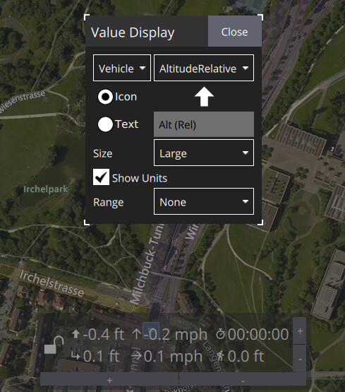

New instrument values setup

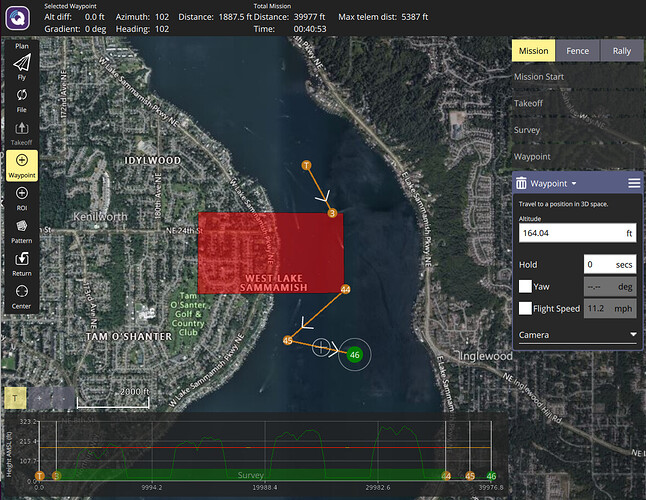

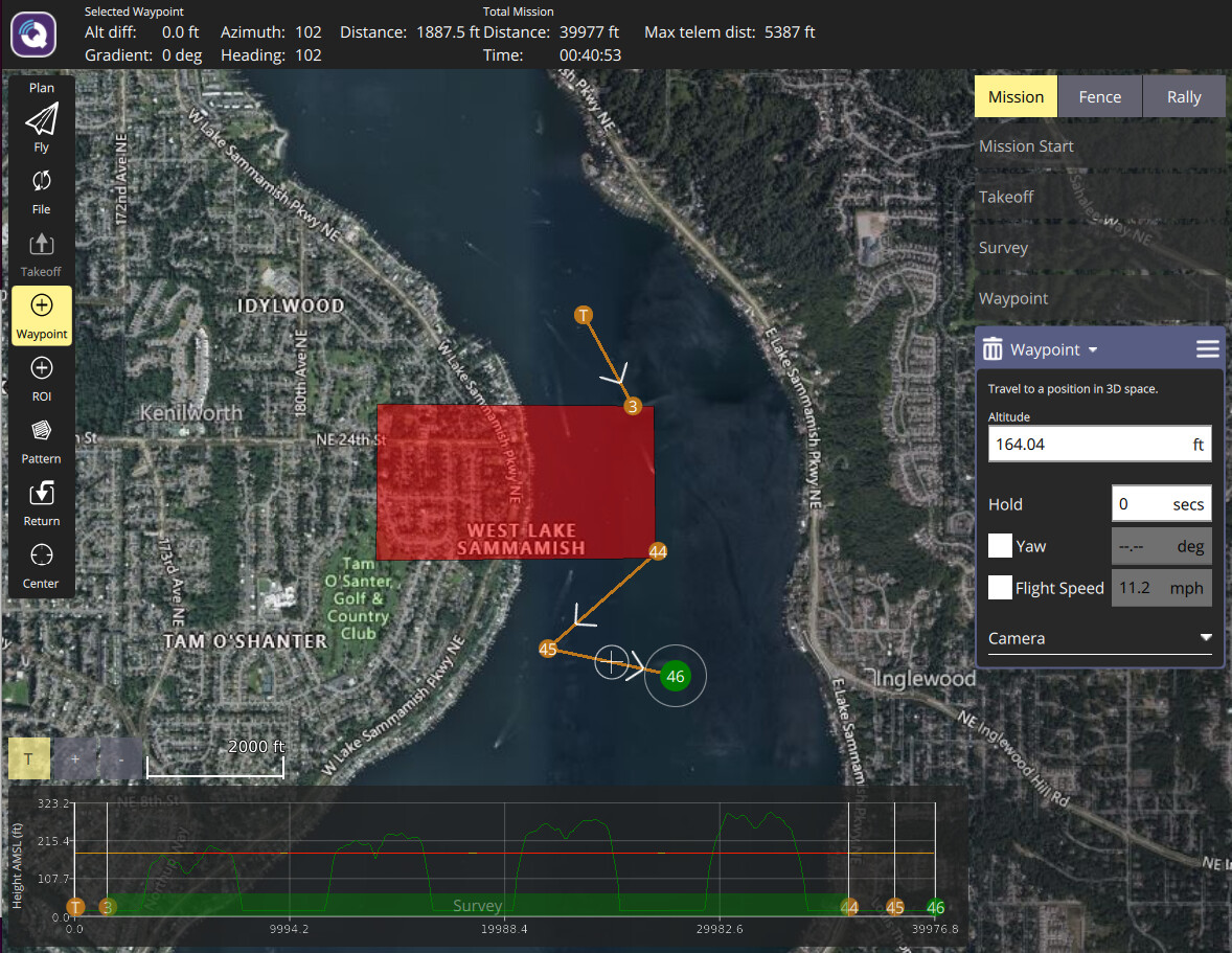

Terrain Profile showing terrain collision in survey area
