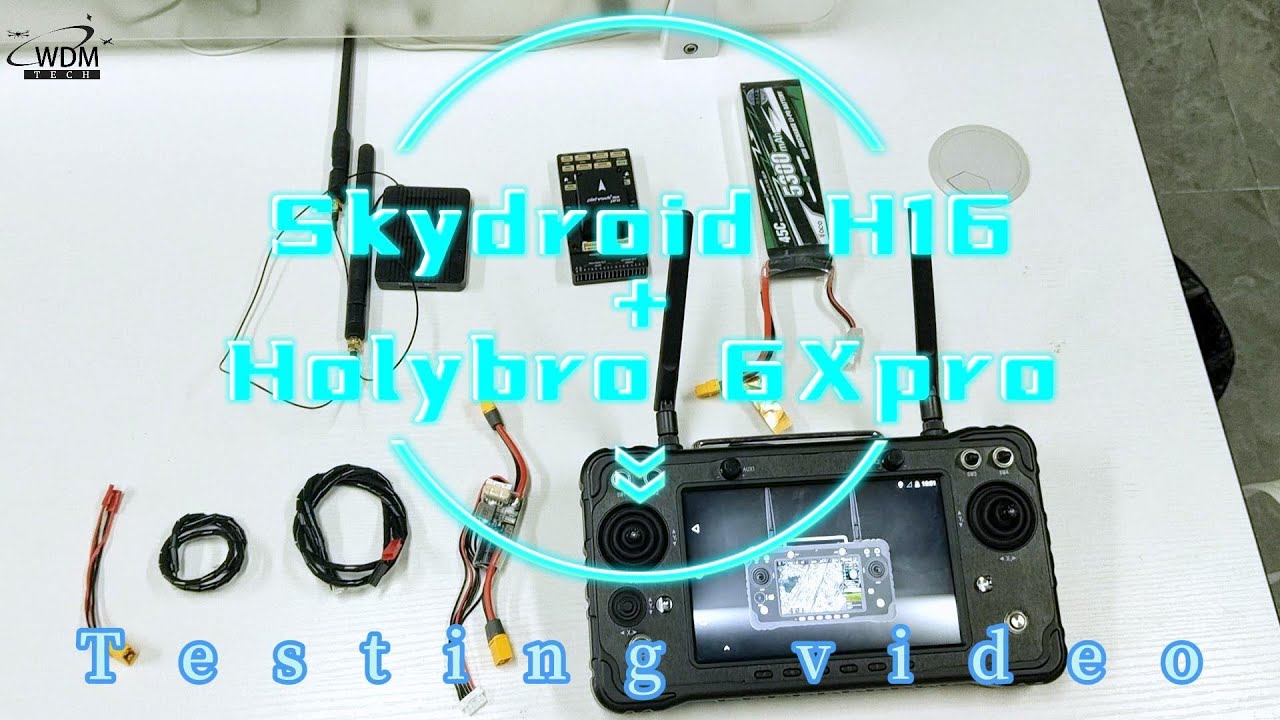

I found the reason for initial problem of missing connection between Flight controller and Skydroid H16 pro QGC (telemetry), it was the wrong cable supplied in the H16 -pro Kit (H16 Receiver UART0 and TELEM1 of the flight controller) by Holybro, the cable match by mechanical , color and form, but electrical the wires connections are not correct. Now, until I’ll have the Skydroid H16 functional I can’t try anything , but is very clear this cable is not the right cable, until now I didn’t receive any response from Holybro or Skydroid regarding the tablet restarting.

UPDATE: CUAV is shipping the wrong URT Cable. I noticed in a video from WMD that my black and reds are reversed!!
Sliced them, cross connected them and boom. QGC came to live ! on UDP port 14551 as advertised.
Damm You CUAV for making me loose so much time.
@John_Leon you rock, mate!! THANK YOU!! It was the cable, freaking Skydroid sent me a bad telemetry cable!! My cable had a slightly different mistake though. The pins for the Telem1 port on the Pixhawk baseboard side of the cable were off by one place…
After your hint that Skydroid doesn’t know how to or doesn’t quality check their cables, prompted me to figure out what the correct order was. This video below was perfect. The presenter did close-ups of each cable in a good orientation to confirm ordering for GH1.25mm 3 and 6 pins. That’s how I figured out my MAVLink data (Telem1) cable was lined up wrong. Anyone having trouble with Skydroid and Pixhawk 6X or later should watch this video VERY closely and confirm the pinout is what the person shows in the video. Remember the Telem dat ports are old serial data comms!! Tx on one side goes to Rx on the other and vice versa!! Hope this helps :sunglasses:
